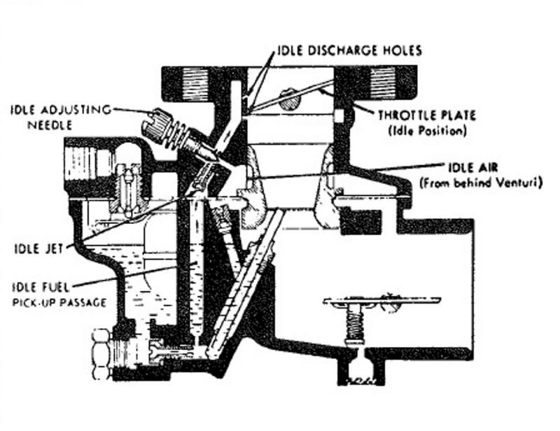

Question, I cannot get idle jet to come out, the brass slot is wanting to chip off. Can I leave it and just use small wire and compressed air to get it cleaned out?
Also, the directions I was following says to remove the main jet where float needle goes and that there is another screwed in jet down in the hole.....I see nothing but a hole down there. Was I reading right, is there one down below?
You've likely already finished this but for posterity, I would try to remove it, there's a cavity behind the jet that could hold debris and cause issues later on - Try soaking with either Kroil/PB and then hitting it with a butane torch. Be sure to use hollow ground or gunsmith's screwdrivers to avoid tearing out the slot on the jet.

Ran into a couple new problems,...the kit I got came with three new jets, but none fit into the "economiser" jet. They are either too big or just fall into hole. I cleaned up the old one as it came out easily, will have to reuse it.
I also found out there is a jet waaaayyyyy down in the main jet that needs to come out, can't even see the booger. I have no screwdrivers that will fit, guess I am going to have to break out a the grinder and make me one.

The carb kits that are now available fit a multitude of models so I'm not really surprised the jets are different sized - Soak the old ones and run a torch tip cleaner through them.
You could actually remove the economizer jet as it only serves as a vent.
This is what I have recorded for jet sizes for the 241B:
Idle Jet Minimum Size = 0.032, Max = 0.046
Economizer Jet Minimum Size = 0.046, Max = Whatever It's just a vent
Power Jet Minimum size = 0.043, Max = 0.053
