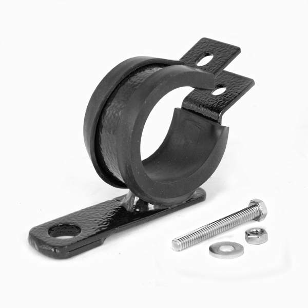

I have the brush guard as well and was thinking of something similar. I hated to drill through the brush guard though. I was thinking of removing the mounting bolt that comes with the light and using a hose clamp to through the base of the light and and then around the top rung of the guard. I think keeping the light on top of the guard would be better to throw the light out in front of the blower.

Check out that clamp that 396 Big Block found. No drilling needed unless your talking about running the wiring through it like I was wondering.
