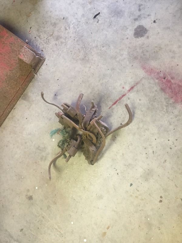

Over I go and there is the rear hiller, a complete dozer blade and some strange pointed pick set with cast mounts that he said are for weeding

Those strange pick tines were the first tines Rototiller, Inc put on their Model T way back in 1949. Those tines are really good for rocky soil, but their drawback is they don't slice. They tend to collect weeds, grass, and roots. I did a flower bed one time and those tines found all the fine roots from a nearby maple tree.
17,152 Posts
Yes, sounds like the pick tines, manuals from the 70s showed them as an option (for rocky soil, as Charlie mentioned). Any idea why they stopped offering them?

Yep according to the owners manual I have they are pick tines and I also found out today after seeing them in the book he only gave me one side so I called him this morning and left a message. I would say the other size is still still there somewhere hanging complete on another rope. I hope so
Mike
Probably, convenience. The bolo tines does both and lasts longer. I had the pick tines on my Frazer Rototiller and every few years I had to replace them and they did not work well for chopping stuff in the garden. I had a set of the cultivating tines that I changed to after the initial tilling in the spring. Attached a photo from the T-B manual of the cultivating tines that they offered. These same tines and holders were used on the Rototiller tillers made through the 50's.

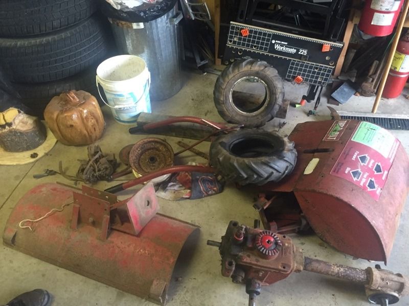

Well here is horse tiller No.2 all torn down and ready to be cleaned up and done over
Gearbox is in way better shape than the 1st one I have apart and just needs some seals
Also landed a brand new honda clone 6 1/2 HP today still in the box in a guys basement for the last 7 years.
Looks like I may have two troy working horses in the end of this. The second one one can tell has way less hours on it and other than sitting outside for god knows how many years came apart with just one broken bolt
Other than that *** left wheel again. Man this one I had to make up a pulling plate with 4 -3/8 bolts since it kept breaking bolts when two and three were used and a ton of heat
Oh well some holes to weld up in the rim but that is no big deal

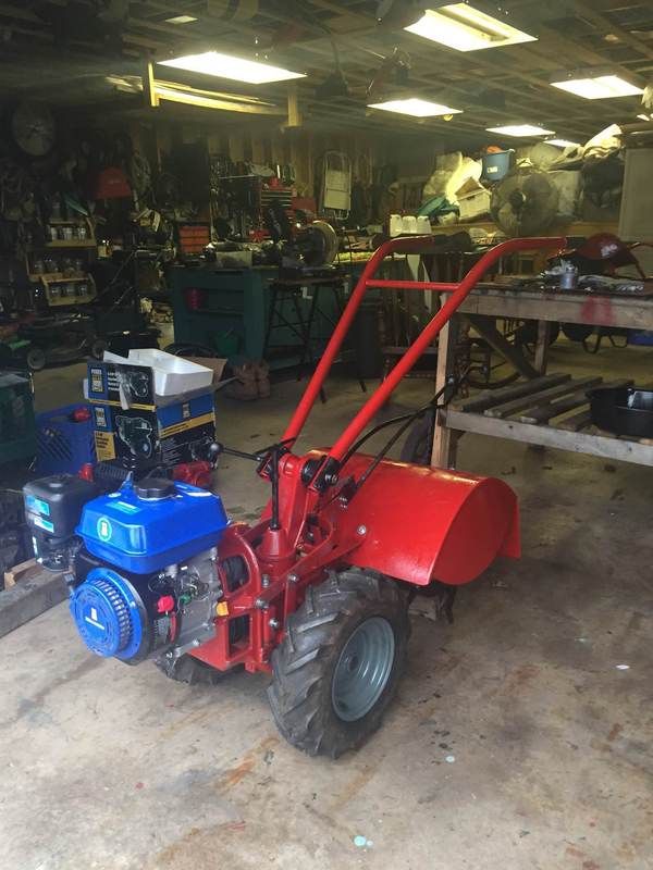

Thanks. It went up to 50 degrees here today with snow they say on Tuesday so I got at it early and put in a full day so Tiller No. 2 is just about done
All that is left is to put the new decals on it when they get here from the US, put in some gas and adjust the forward and reverse lever and add the new gearbox oil when I find it, install trottle cable
She is no show piece but looks OK and built to work
I think it will do that well. I hope :)

Sorry for the different non factory colors but I wanted to use up the paint I had kicking around
