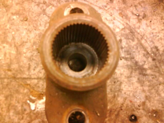

So is everything all good now? Does the blade adapter have a spline? I have an adapter for a Tecumseh, but it's for a spline shaft.
By spline do you mean that little notch in the shaft that aligns with the protrusion in the adapter?
This is what i mean....
Crap mine takes the other kind with just one big notch on the side of the shaft.
check to see if flywheel key is also sheared. this happens easy on this engine. snapper used tech engines for some models. should say big 6 on the shroud. me and my neighbor have this same model. that splined blade adaptor looks like it came from an ariens
came off of an MTD
