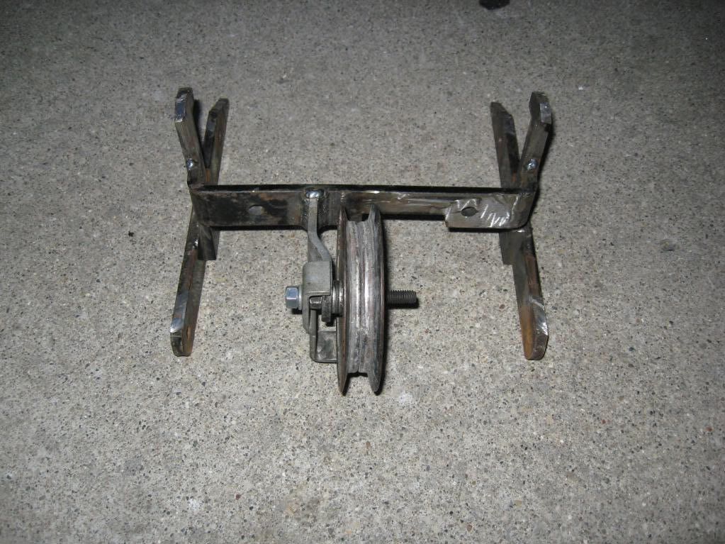

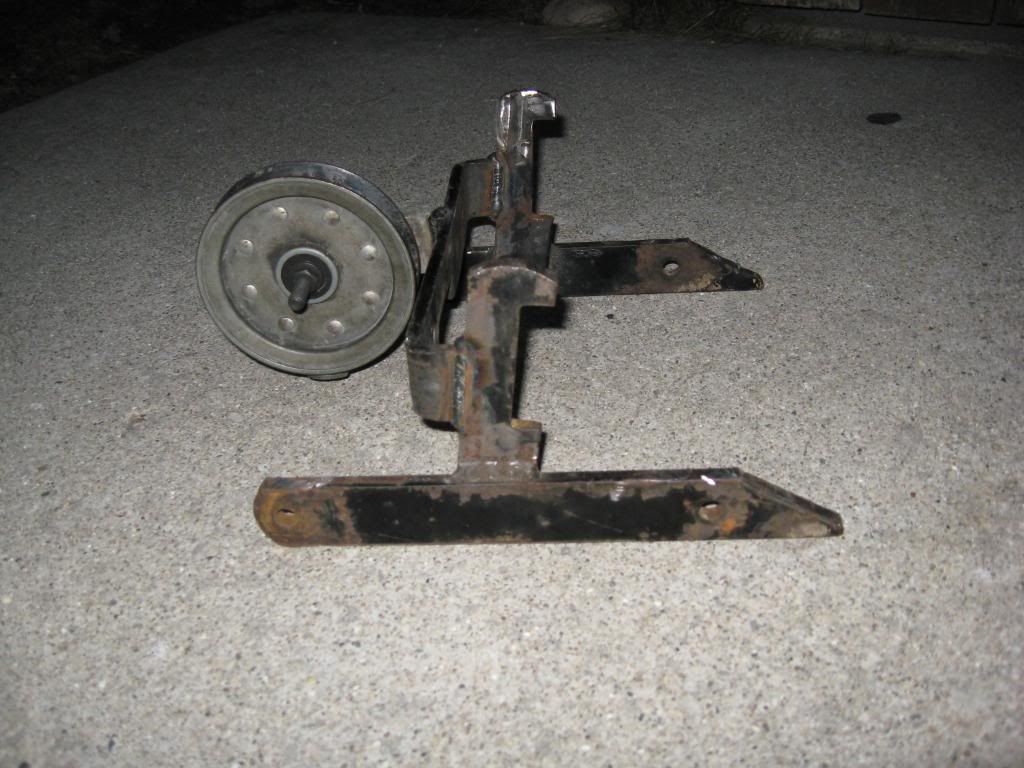

Old fart, here is a couple pics of the hitch you will need to run a blower on your 7116. the blower you buy should come with it & hopefully a belt.
a 32" will work on your machine but you wont be happy with the narrow path it cuts. it will be narrower than your tire path. stick to a 42".

The blower hitch above looks homemade or modified a bit. This is a factory hitch design.
A 32" will also run at a different speed, or require a change to the driven pulley on the blower to make it run correctly for your tractor. I would keep your eyes peeled for a 36" or 42" (I prefer the way a 36 throws better, but they are harder to find for later machines)

yep, i made it from a double pulley hitch.
