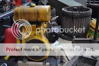

I'd like some info on doing a swap from the Onan to Kohler, I got a good deal on a 14 hp today and would like to use it on a parts tractor I have. I need to know the location of the motor from the front of the chassis and if I need to or should use the motor mounts, It's going in a 71 446. Also if someone could take some picture,s of both sides of there tractor with a kohler in it that would be a big help. I did get the motor running in the back of my truck, runs nice, no smoke. Next is to put together a parts list.

This motor came out of a cub cadet. My plan was to make a list of parts and start searching. I know the crank is the right size for the love joy, I don't have the housing yet to check the bolt pattern on that, also the bolt pattern for the clutch looks the same. I do know the bolt pattern for the oil pan is shorter in length but same width as the onan. I can check today the hight from center of crank to frame for the hight. If someone could measure their oil pan hight that would be great, photo,s are a big help too! I really don't want to get another donor if I don't have to, the hole reason is to bring the parts tractor I have back to life and pass it on, finding good usable onan's at a reasonable price is very difficult and I'm in the middle of rebuilding my second Onan in as many months and I'm all set with a third! Thank,s for the replies, I'll need all the help I can get.
