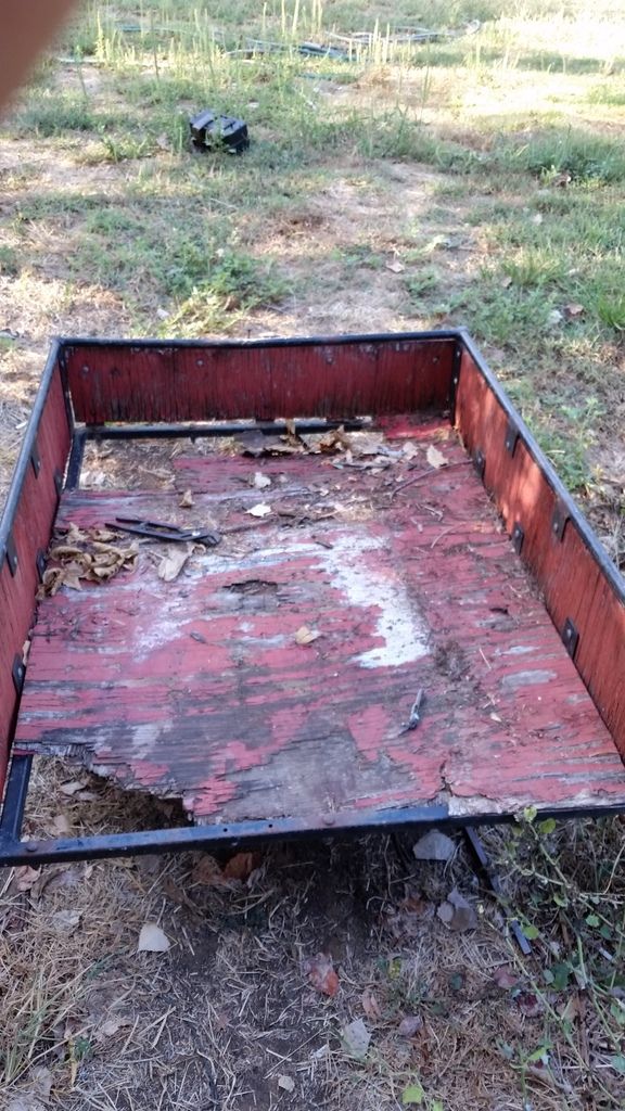

Built this little trailer outta scrap nearly thirty years ago. Plywood. I saturated with Thompson's Waterseal several times and allowed it to soak in. Painted with plain enamel. It held up very well being stored outside, but the wood's had it! Pneumatic tires at first, but I got tired of flats and converted to solid wheels. I decided for the rebuild, it's time it had a tailgate too.
I'd used around 50 or so 1/4 20 carriage bolts. Rather than take too much time with them I cut them off with a disk.
I'd made it a dump trailer back when I built it. In everyday use I decided it was absolutely not necessary. Just as easy to unhook it from the tractor and raise the tongue to dump.

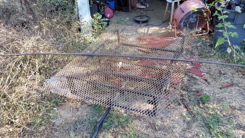

I also decided to go back this time with something that wouldn't rot. Smooth expanded metal. That's gonna require shorter spans between supports. 1" angle iron stringers welded to the cross members will do that.

This morning I was tacking down the expanded metal. A tack here...tack there....one over there.... Hey, where'd my nozzle go? Nozzle gone. I looked for twenty minutes. I believe it traveled through a worm-hole into a parallel universe. I just now got back from Dallas where I got a new one. If I ever clean my workshop I think it'll probably show up.
