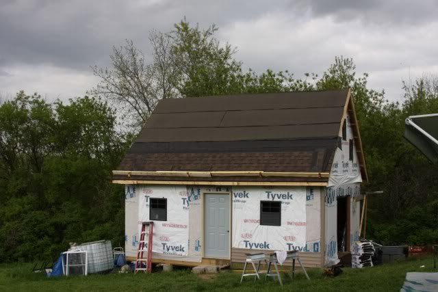

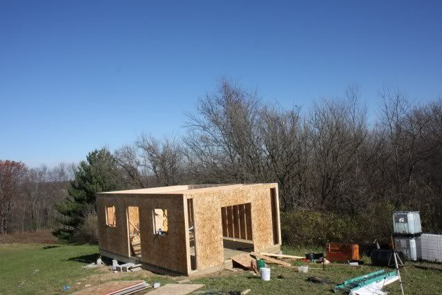

Started it fall of '10 and just doing some tweaking now..Header upstairs for the door, safety catch for the stairs, hanger for the 4x4 on the stairs, I was thinking of putting a 2' eyebrow above the rollup door to keep some of the rain out...was going to add a large arbor over the whole front area like 8x22 or a leanto. Did most of myself, only help was one day to help set rafters and main beam and to help sideing and soffit both gables...other than that no other help....

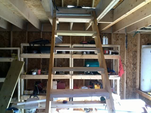

I put the stairs on a winch to free up floor space

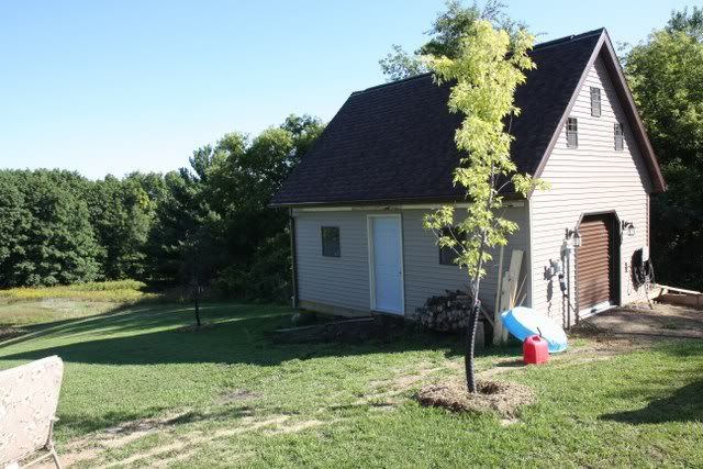

But, I'll bite, why is the one corner pylon (left of the pedestrian door) not full up to the floor?

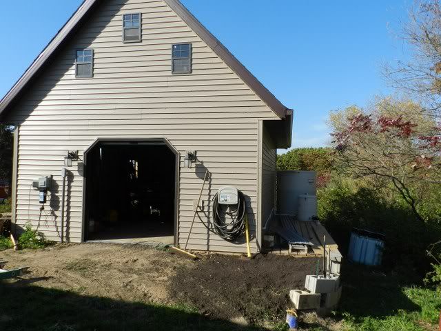

....I drilled an anchor bolt too close to the edge and it cracked..I chipped it down to the ground and repinned to to the footings..it was a a touch short so I put 3 steel shims there..:banghead3

Actually I have mine plumed and it goes to a water pump so I have pressure..the pump is in the video near the end.
I was just trying things, but what I will do in the spring is run pvc from the gutter, put a T where the tank will be and run 30 feet of PVC under the shed and it will act as a sediment filter for dust and other small particles on the roof there will be a valve at the end of the pvc pipe cracked open a bit so water will drain each time it rains.. I do have screens on the gutters to keep the big stuff out.
