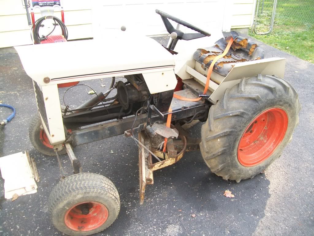

Hi all from Ohio. I recently acquired a Colt 2712 and I want to fix it up. I found this sight and I'm hoping to get some help. :thanku:
Yes Sir... it is a little treasure and one that I'd love to own myself. Work closely with Steve and you will end up with something you will be proud to own and perhaps pass down to one of your children.Thank you for the detailed information. I'm not going to work this tractor hard for sure as I realize how important it is to preserve it. I envisioned it as a snow plower for my driveway and pull my kids around with the trailer. I don't think that would be too much.
The axle shafts and motor input shaft fail by twisting off due to procedures that require high amounts of torque. Mowing your lawn or pulling you kids in a trailer are low torque uses but pushing snow or plowing a garden can often be high torque situations.

My front end does have a stress crack. I'm a certified welder so that's not a problem. The front axle where it pivots is worn pretty good also it seems. There is a lot of slop when turning the steering wheel. The axle rocks forward and backward. I plan on taking it apart and seeing how it can be repaired.
The axles are cast steel and not difficult to repair. I suggest that you bore out the pivot hole and bush it back to stock with either a steel or bronze insert.

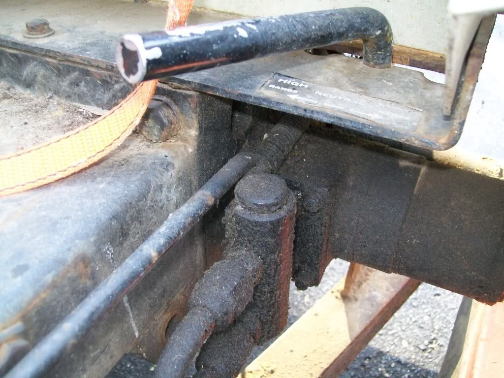

I was thinking that it was supposed to be hooked up to the hydraulics but I wasn't sure. Thanks again for the lesson.As I said before, your tractor is fitted with the optional hydraulic implement lift that I wasn't even aware was available in 1966 because it does not show up in the parts manuals until the 155/195 models were out. I suspect that there was some sort of a "lift link bar" that connected the hitch to the hydraulic implement lift but you don't have it. In the early years, Case relied upon Brinly-Hardy to make sleeve hitches for them. When the 200/400 series tractors were produced, Case moved quickly to engineer their own 3 pt CAT 0 hitch plus their own sleeve hitch. Those sleeve hitches all came with a removable lift link bar to connect them to either the manual lift or the hydraulic lift.
I think that if you carefully examine the hitch you have, you will find a short arm welded onto the right side of it with a hole in the end or perhaps a pin sticking out. It's just a guess on my part but once again, a chat with Steve might clear that issue up for you very quickly because he's seen quite a few Colts over the years he's been collecting. He may have some factory literature on the hitch that he would photocopy for you.
