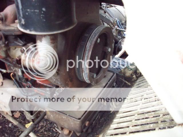

It seems like everytime I try to start my 1050 the battery would be weak and since the starter generator isn't the best I always needed to jump the battery to start the tractor or Take the s/g belt off and pull start the engine. I got tired fo doing that real quick lol so I came up with a plan to fix it.
First I got a spare pulley that is used to start the engine I just bolted on top of the first pulley. The only things needed to do this are 3 2.5 inch bolts and a second pulley. The result is that you can keep the s/g hooked up and still have the ability to pull start the engine if your battery happens to become weak.

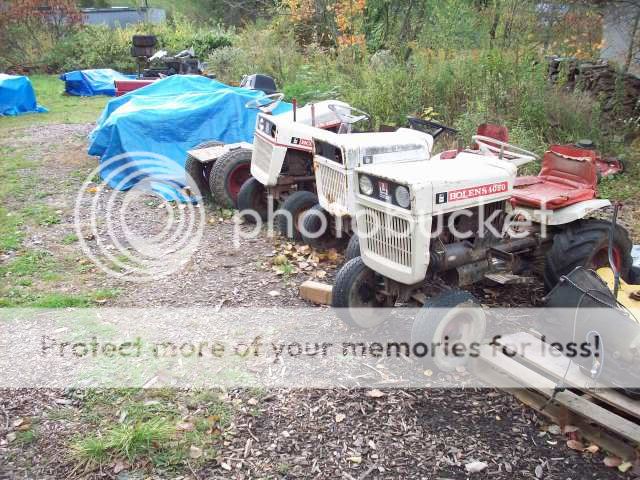

Just for fun here is a piture of my row of 1050's LOL

Nothing like a good supply of spare parts.

Also believe it or not wehave plans to repair the three tractors that look like and may be parts tractors lol. I have been slowing working on restoring the furthest on back in the picture.
