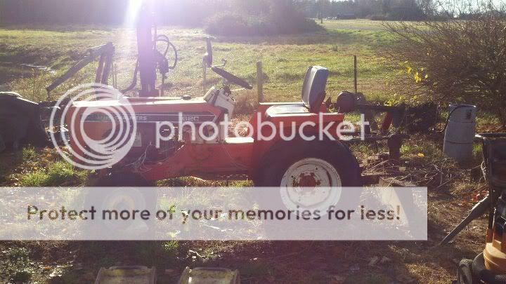

Buddy of mine just recently passed away so I was offered this machine by his daughter. Of course I wasn't about to turn it down. I don't know much about it other than has a new motor on it that isn't suppose to be on it. It runs, so thats all that matters. Wonder if my snow plow from my homelite would fit on it. Looks like it would but haven't tried it yet.

That tractors had a rough life but you still can't beat the price. Its considered a "powermax" series. I suspect from the white dash it might not be a 620. It could have been the Simplicity version that someone threw an AC hood onto. Unfortunately the homelite blade is different. I suspect the mounting points will be too narrow. These tractors had much larger hydraulic blades.

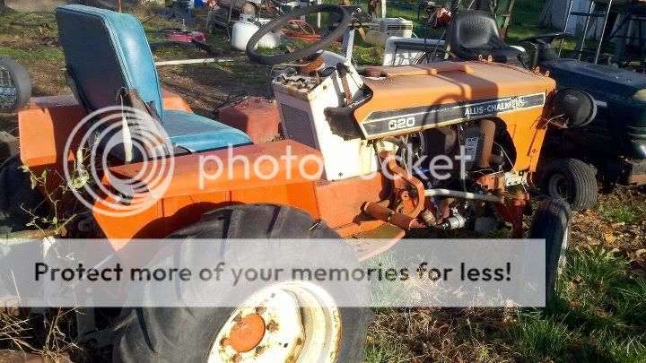

Well I got it on a trailer. Back tires would roll but it was tough. NO match for a winch lol. Anyway here are some photos I just took of it.

Its rough but a nice score none the less. So whats the plan? It mite be a little to far gone for a full retso, but it will defiantly be a nice work tractor. Hows the charging system with the gm alt. on it?
419 Posts
It's a Simplicity, with a cut up hood on it. Originals had Onan engines, if the Briggs was put in right and is in good shape it's not a bad deal at all!
