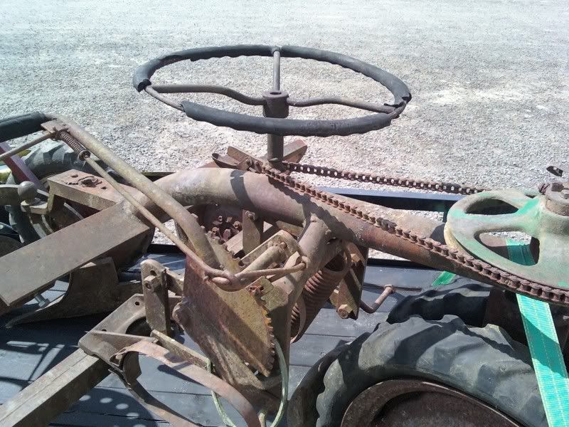

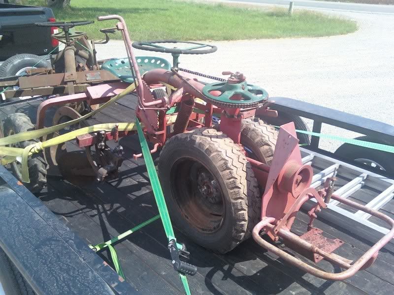

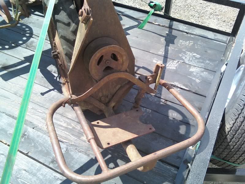

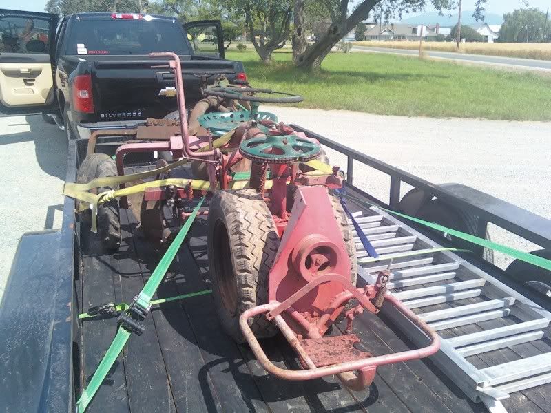

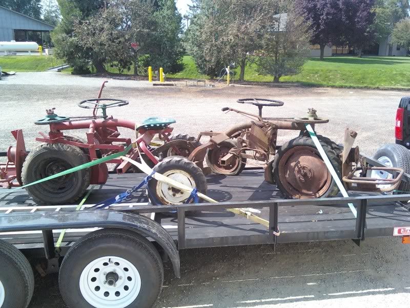

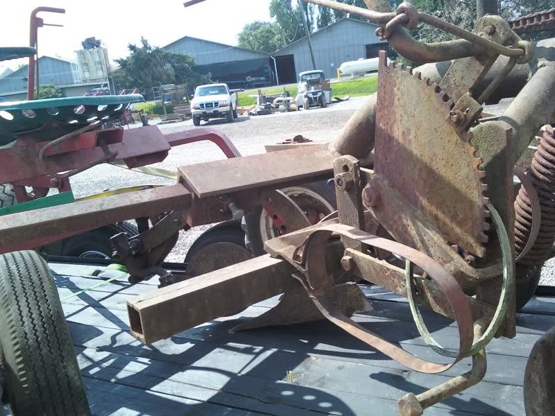

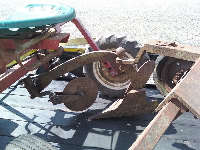

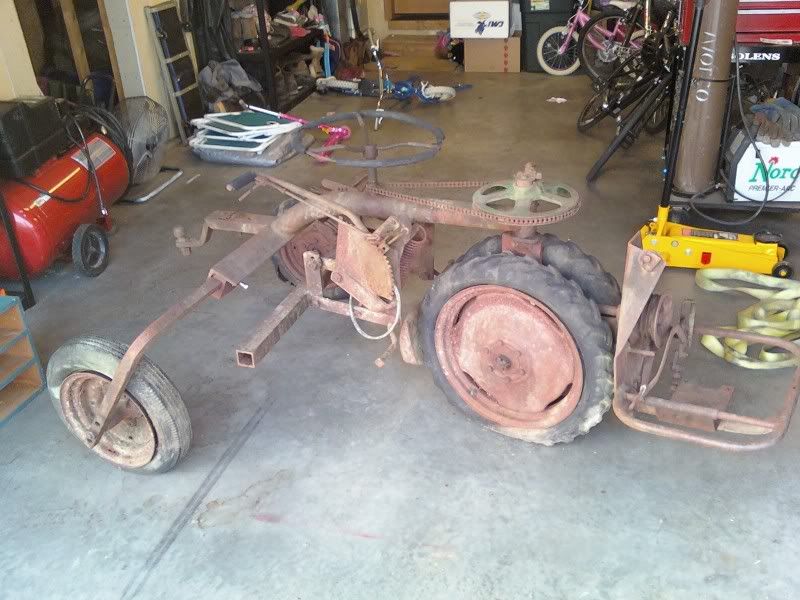

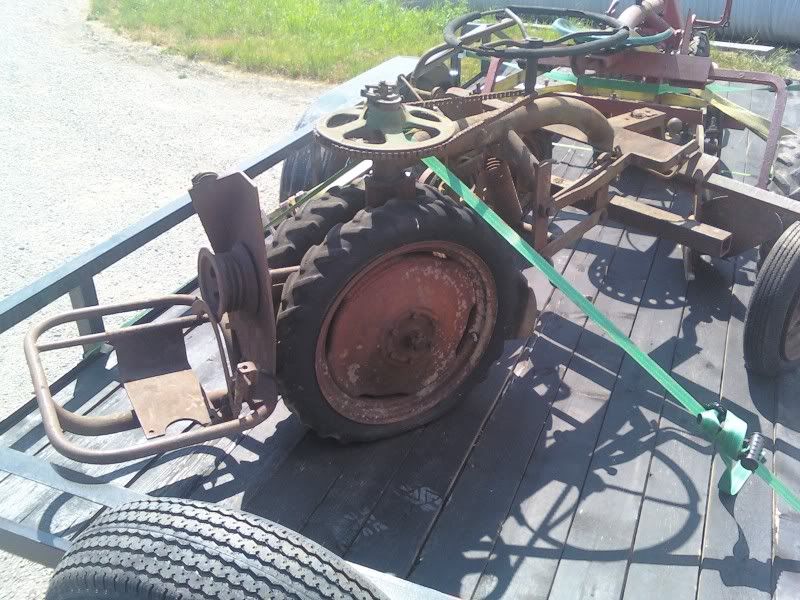

We picked up two of the first Ridemasters made, the Beancutter. This one originally was red and was a little simpler, but not much. Anyways, I am going to restore one for my dad and one for myself (happy 60th Paps!). I am currently working on the rusty one which is actually more original but is all locked up. These things are very simple and I will probably have it done in no time. My brother and dad will probably help out so I'll update you all on our progress. I am very excited about these as they were the first of the Ridemasters and seem a little more unique. I can't believe the guy I bought them from found two.....Anyways, enjoy the picks. I even found fresh paint which will help me when it comes time to match the right color. We also picked up an AKN engine for the first restore.

Feel free to ship that plow to me.

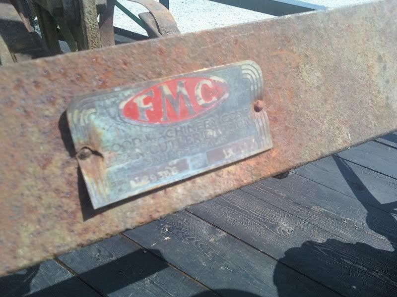

Thanks for straightening me out on the name Ray. So these things are Bean Cutlers, not to be confused with bean cutter.......LOL. Rookie Ridemaster collector mistake.

Gonna run to my dads this weekend and sandblast. Everything came apart fairly easy but I still have to free up the tranny.
Now comes the hard part.....getting that pulley off.
