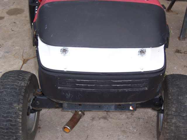

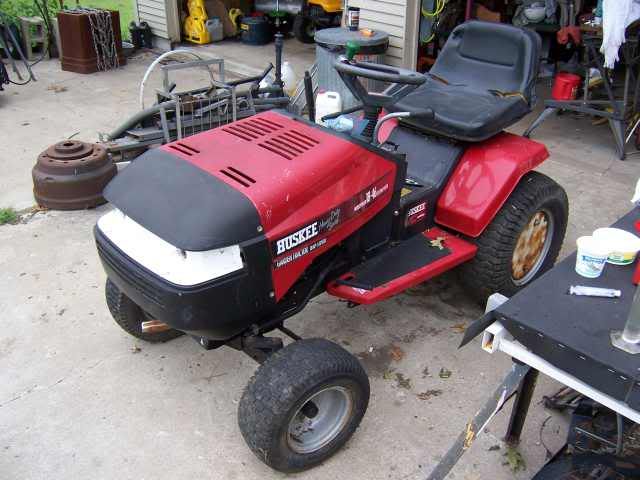

Here is the results of my "I got nothing better to do today" tractor rebuild efforts. Ugly as homemade dirt but it has turned into my "trailer tugger". The wheel weights are home made out of 3/4" steel plate with smaller disc of 3/4 welded inside. I don't know what they weigh but can attest they are heavy (75 lbs. each I am guessing).
The plastic nose piece was cracked but a bit of Duro brand "Plastic Welder" fixed those. I recommend this stuff highly for plastic repairs.
The sleeve hitch came with the tractor. I just needed to make some pins for it. I need to make a "ball hitch" adapter that will let me back under the hitch and lever the tongue up enough to move the trailer for mowing.
I have found an old snow blade that my father had for something. I may try to adapt that to this tractor for times when I need to push a path to the mail box but it isn't deep enough to get out the snow blower. I use it to drag a harrow to level the gravel drive and drag brush to the burn pile.
