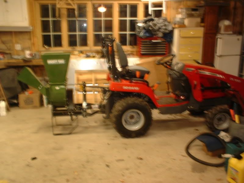

ummmm..... pictures?....
I'm not reading this review until there are pictures!!
LOL!... cheers!
ditto, we need pictures and or a video!:thThumbsU
I guess I should have taken pictures when everything was shiny and clean, now its all dirty. Heh heh. Oh well, I'll snap some pics tonight for ya.

As an owner of a MF GC2410 I would also like pictures and if you are up to it a video clip or two.
I have been collecting a file of info on chippers for my tractor for future purchase and this model is in the running with a few others.
I look forward to the eye candy!
Oh, and dirty tractors and equipment just confirms they are not barn babes and they work for a living.:fing32:
Clean pictures are for the show room....I like the in use ones myself:)

Here's some pics for all. Slightly used of course!
