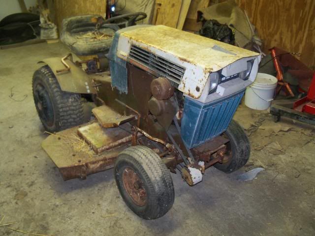

Okay, joined a few weeks ago as I decided to get this machine going, finally got her home and took some pics.

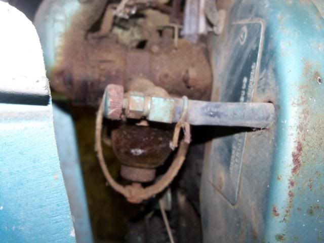

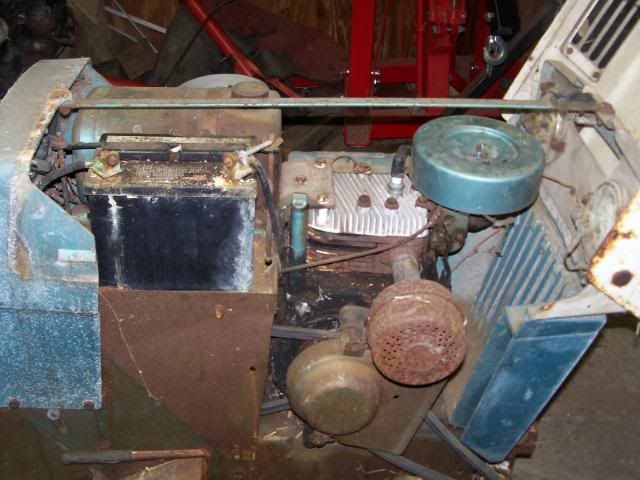

Little history....My wife's Uncle Bob purchased this tractor new I believe when he moved to country. Before he died some years back, he gave me this tractor, I never picked it up until about 4 yrs ago after he passed. I asked my father in law if he knew anything about it, all he could remember was that Bob had rebuilt the motor in the 12hp ( he had a 8hp too). So I really have no idea what i really have. Other than getting a Sears SS12 with 3pt, single plow, 44" deck, discs, and trailer, not sure if it ran, if it was rebuilt, etc. I took it to my dad's and parked it in an old 3 sided horse leanto. I know it was always garaged, guess the weather did more damage the last 4 yrs than the previous 35. So, with out any further rantings, here's the pics.....I'll have plenty of questions at the end.

Thats a 1968 Sears Super Suburban 12 (SS12) It has a Cast Iron Solid State Ignition Tecumseh HH120 12hp engine.
Clean the tank, replace the fuel lines, clean the carb, give it some starter fluid, and crank her over!
Edit: the mower is a 42" by the way

pull the taNK OFF. you wont get it clean on the tractor. good chance it'll leak too. while not a huge deal, start with that and save some aggrevation.

thanks, I just threw a tape on the deck to see if it would fit on trailer, thought it only had 4" chute so assumed 44".
You got a sticky somewhere with all the model numbers?
I'm going to pull/clean tank, replace lines, plug, clean/replace filter and carb. I also have to see why the positive cable is stretched tight..????
What about swapping to a newer plastic tank?
My plans are to get it running properly, make sure everything is in working order, then do a complete teardown and resto of some sort. maybe not completely factory, but freshen up a bit. I've already been doing tons of searching on building blades, love GT-80's rear grader blades.
Uncle Bob used this tractor to put in a 1/2-3/4 acre garden every year, plow, disc, and also cut grass every week, Would love to get it back to it's glory days.

Check the sticky forum and look for GT_80's thread with the link to all his free manuals, he has this exact same tractor, so I think he has a manual.
As far as the tank goes, give it a good cleaning, very easy to do. plug the spout on it, then put some gas in it, 3 or 4 nuts, and shake it for 3 mins, like a can of spray paint. drain, and repeat once or twice.

that is sweet! That is the first "horn button" i have ever seen on one, and you have the "usually missing" grille piece that everyone loses when they put the snowblower on. Nice machine!!!
