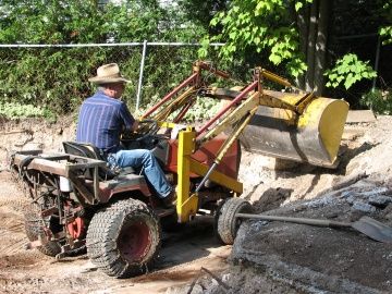

I park mine with the bucket in the dump position. Even then the cutting edge has to be on a 4x4 to get the hood fully opened.2nd, with the way he mounted the attachment point for the single bucket tilt cylinder and the fluid reservoir, he didn't leave much room to raise the hood. It was almost impossible to gut gas in it. To correct that, I cut the hood at the seam, and added hinges so that I could get access to the fuel tank. I stole that idea from another MTF member![]()
