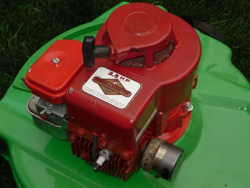

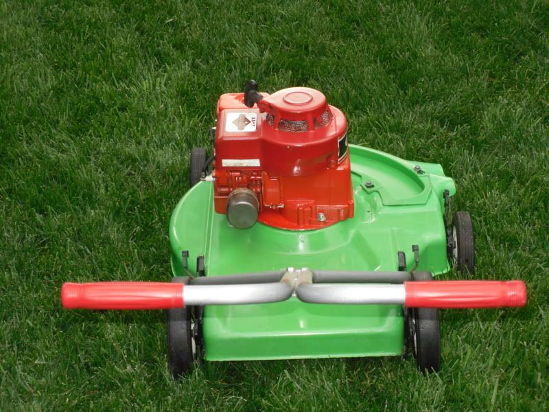

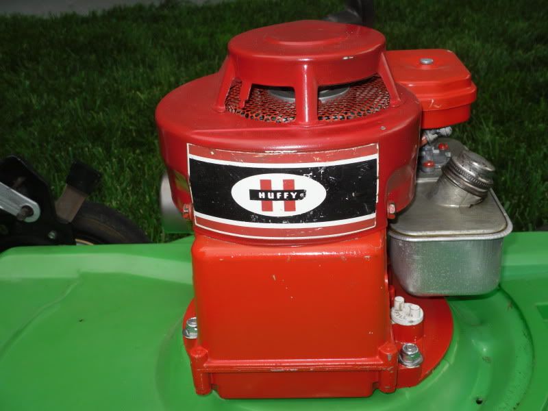

This is what you get when you take a 1970 3.5 HP B&S engine from a Huffy Push mower and mate it to a "V" series Steel Lawn Boy deck and add some spare parts. I got the engine off Craig's List from a man who's grandfather replaced all the gaskets and painted it, and then stored it in his basement for many years. To get the engine running all I had to do was replaced the carb diaphram and clean the carb out. The engine really does start on the first or second pull and runs great! I used a old style MTD blade adapter and MTD Mulching blade and added a butter cup handle for a vintage look. This is the only way the engine will mount using the stock holes in the deck, so since the muffler points right in your face i made deflector for the muffler to shot it out the side. At a later date I was thinking about painting the deck a gold or copper color for real vintage look. I want to keep the engine the way it is because all the time the man spent on it.
