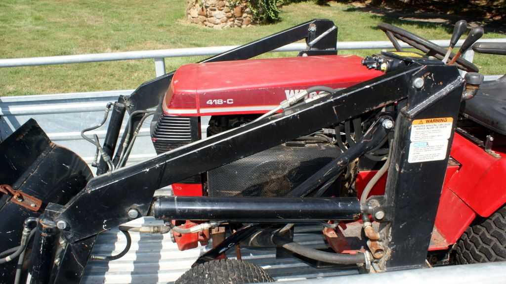

Just picked up a Kwikway Loader which is missing the "Brace Arm Mount".
Any chance anyone owner could post up a few pics of it with the dimension ?
I would like to fab it up close to OEM if possible.
Wheel Horse version of course.
Thanks
Missing Part Pic Below

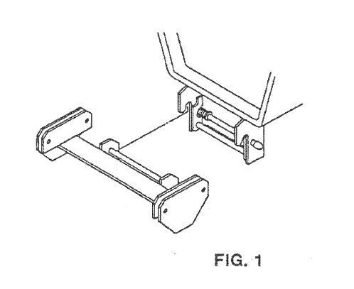

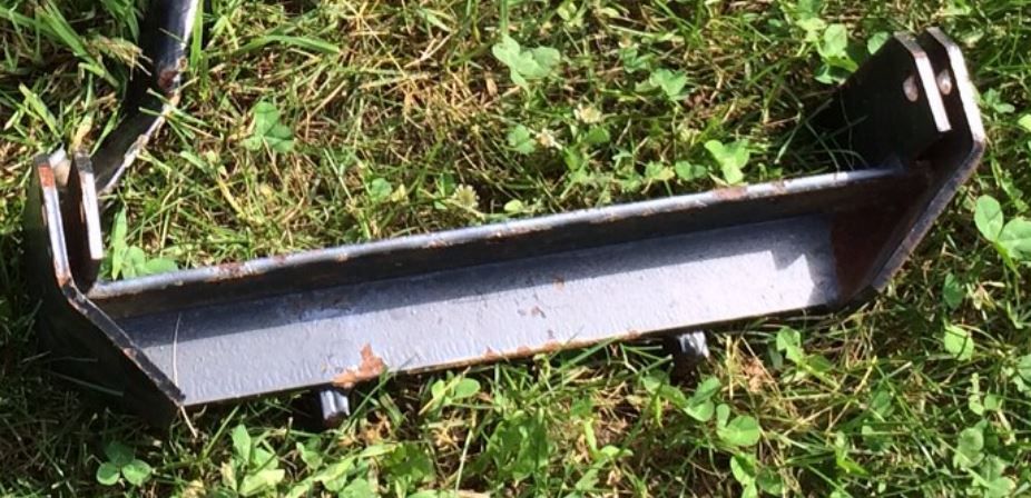

A few more pics.
The main center looks like 1/4 thick angle iron (maybe 1 1/2 legs) and the plate ends 1/4 as well. The other side is a snug to the Wheel Horse attachamatic on the front of the tractor. Looking forward to getting it running. Power washed the 418C and loader yesterday, looks nice.
I had a member over at Redsquare respond and the pics are posted.
