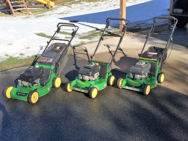

I like my JX 75 so much I was on the hunt for another one for a spare or at least spare parts. I came across this deal the other day. Three JX 75's, model year 2000, 2002 and a 2006. The 2006 is in almost prefect condition. I haven't tried to start any of them yet. I'll take them one at a time and go through them over the winter and see what I got. I was able to get all three for less than the cost of a set of replacement wheels so I'm happy with that. What do you think? Good deal?
