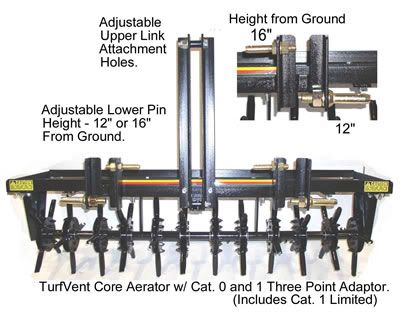

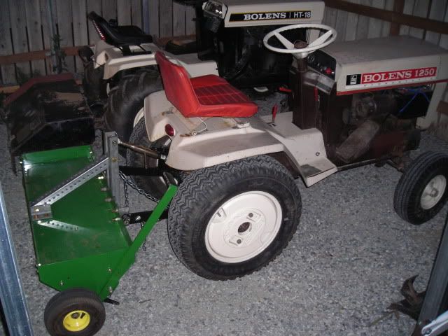

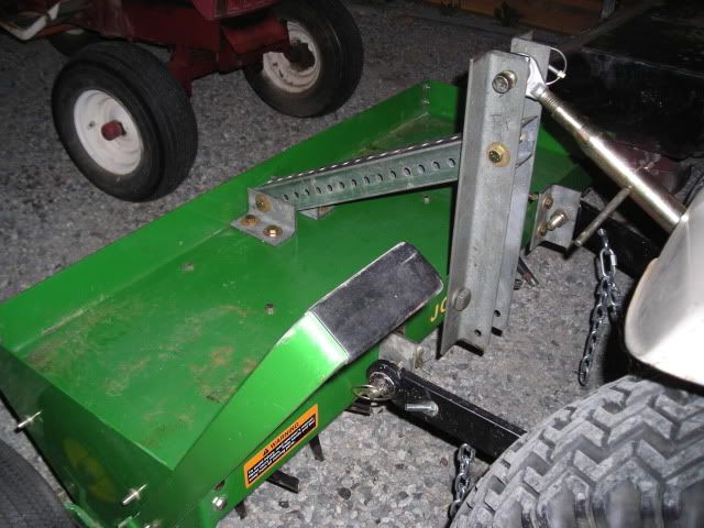

I finally got busy and modified my JD 40" plug aerator. I converted it to 3pt. hitch while at the same time still left if so that the original tow arms can be attached. I did not weld and used galvanized angle and box tubing that was readily available to me. I tested it tonight and it worked excellent without weights in the tray. I was able to get 3 inch plugs with the Bolen's down pressure. I also took the design from a turfvent aerator that I found online. Pretty simple conversion actually. Enjoy the pictures.

Justin, that's a nice arrangement. Are you going to take the wheels off the aerator? How much weight can you put on and still lift the implement with the leverage you have, and do you have the capability to add counterweight to the front of your tractor?
I have thought about the turning and decided for my uses it would be straight shots with minor wiggling. If I really planned on turning a lot, I would put the tow bars back on. It really is solid the way I have it set up, surprisingly. I haven't tried to load it up simply because the Bolens 1250 doesn't have a float setting (dang it!). If I had a three point on the HT-18 I would definitely load some weight on it and let it float with the terrain. I will put some weight on it and see how it does this weekend. Also, I may put some angles on that go from the top link to the corners if I need more support. Regarding the tires, I like them on for depth control, but If I need to get into tighter spaces, they will come off. I'm planning on aerating yards on the side, so to fit in back gates, they made need to come off.

I've used their tow-behind 40" model, the farm & garden down the road from my house rents them. They work pretty good, but you still have to weight them some. Doesn't matter how much weight is on the tractor tires, the weight has to be above the pluggers, whether the lift "floats" or not. Give it a shot, it will probably do a good job. The way you put a diagonal brace from the top link to the back of the weight tray is much better than the single vertical piece on the one you linked to. Over time, the added weights will bend the front rail.
