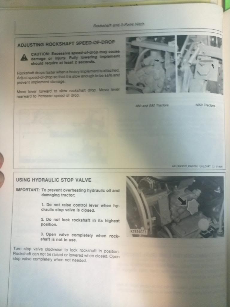

There's a big knob just forward of the orange lever that I was told adjusted the rate of fall... ?
I'll have to play with it some more, but it seems like it will only stay in two positions, all the way down and all the way up.
The big knob under the seat is the hydraulic stop valve. Its only used to lock the rockshaft. This photo is from my factory John Deer Service manual.
