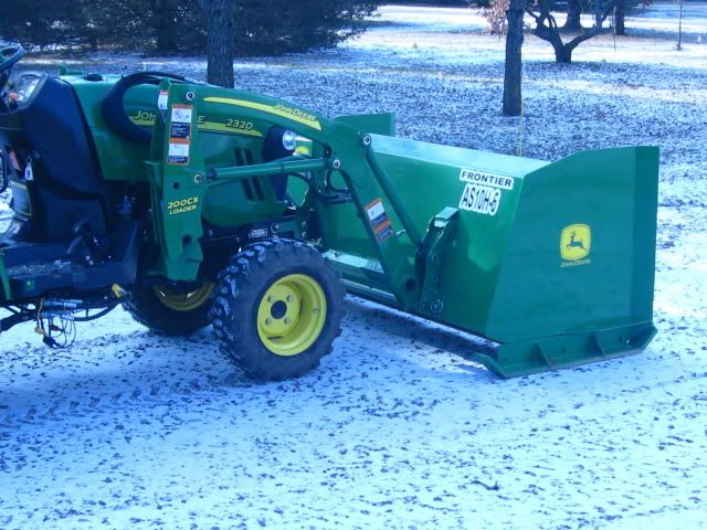

:congrats: That is nice work right there!! Have you tried blading with the tilt pin out yet??? I have been doing that for the last couple years now and works slick for snow!! Allows the blade to float from side to side. Again, great work on the front pusher!! :congrats:

Wow, awesome job! I would think that 10" would be nothing with that rig, last year I did 18" with the bucket on our 855 which is a smaller size/hp machine than yours. Loaded rear tires and no chains, I miss that traction every time Im snowblowing with my 155C.

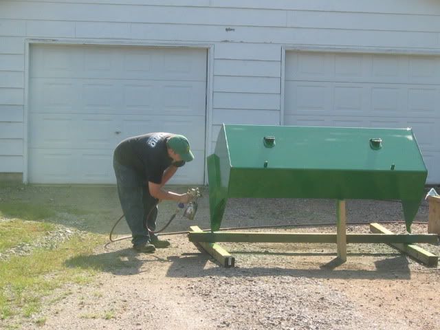

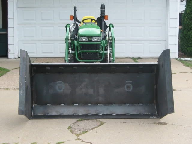

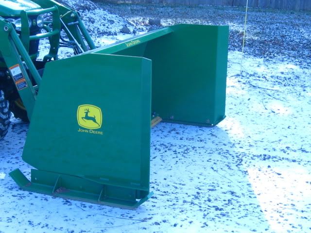

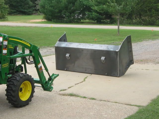

I think it would take a lot to over stress those arms next to lifting ALOT of waight with one corner of the bucket and getting overly aggressive. The pump will not allow you to over stress them with just waight. more pics

I wasn't inferring weight; what some others with this kind of set up's have experienced is racking of the arms due to side to side (angle) stresses that are multiplied by the distance the plow is out front. :)

I am loving that, Nice work, Pushers are the way to go with big areas of snow. I am building one out of a 6 foot plow I am picking up this week. Yours is the 1st pusher I have seen that is actually a pusher. Could you post a closer picture of the shoes. I am building mine to work with the loader like a commercial unit.
