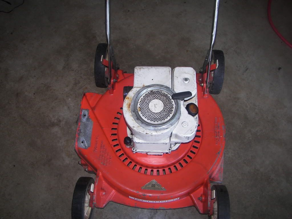

I found this in someone's trash. I got it running. Just took some sandpaper to the flywheel magnets, coil, and points. Started right up 2nd pull after that. I also took the rust off the handle with my die grinder, cleaned the air filter, changed the oil, and sharpened the blade. I am guessing by the Briggs model number it is a 1972. I haven't decided if I want to sell it or keep it. What would someone pay for this? Do people collect Jacobsen mowers? This thing is pretty neat.

Is there supposed to be something on the discharge deal where there isn't any paint? And why did Jacobsen manufactor the deck with the slots in it?
I would guess that there was at one time a discharge deflector on there.
Yeah there probably was and the Jakes had a big one. The one on my comm is huge and made of fairly heavy steel. The vents are curious though, around the deck there...
Other mowers are vented as well, just not obvious like that. That's where your discharge air comes from. Interesting design and cool mower.
