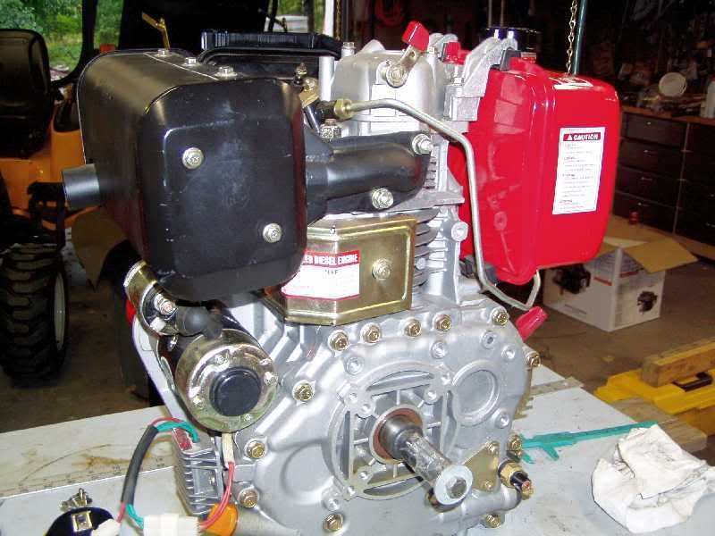

here are some some pics of the pre fitment. It looks like its gunna fit like a glove. The only thing thats gunna be a little tricky is cutting and mounting an adapter to the output shaft.

Yep the new engine has almost the exact overall height.

What does this motor weigh?
The motor weighs about 150lbs... atleast thats what the shipping label said. I REALLY want to use the stock pto off the Onan if at all possible.

LOL pics are deceiving. I am going to have plenty of room.I need to cut the output shaft off. But once I do that the overall length is going to be almost exactly the same length as the ONAN

Engine was off ebay came outa WI and I dont remember the shipping $100 ish

Very interesting looking engine. What make and model is it? What was the original intended application for it?

2 things I noticed , 1: where is the blower shroud? That engine needs it to stay cool, looks like a Lombardi diesel to me, and if it is, it needs the blower housing or it will sieze up when it gets hot.
2; you may want to turn the idle up, as it shouldn't sound like its missing a beat, it can over fuel a cylinder doing that and crack a piston,or worse damage the crank or rods.
