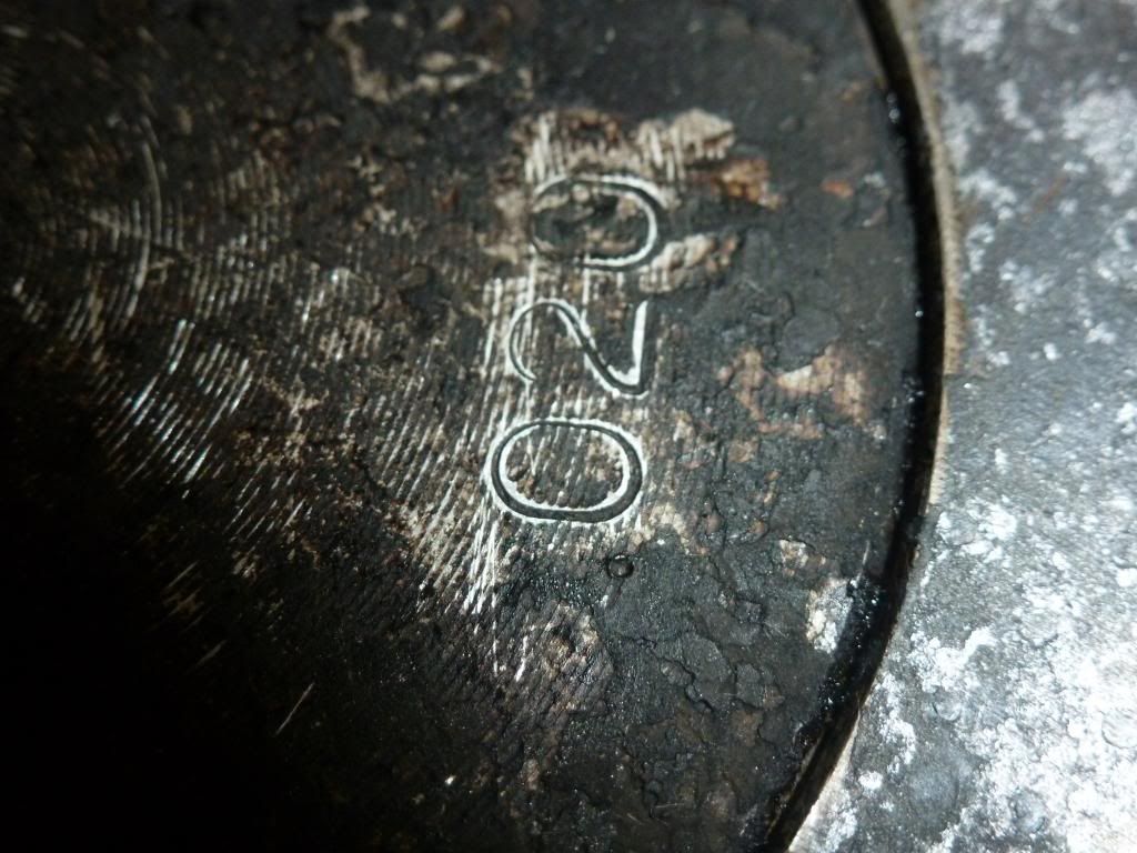

I found the intake valve stuck and a rust ring pitting the cylinder about 1/2 way up the bore.
There are 3 head studs needing replacement. Small job has offered me some for less then the $23 each they are from the usual sources. I'm not sure I want to invest time or money in this block. I'm not doing a rebuild, I have my doubts the .030 over would clean it up, I haven't found a marking on the piston to see if it's std.

Ewwww not pretty on either the intake or the cylinder wall.....
You should be able to clean the carbon off the pistons and it they used an OEM piston it will be stamped.... like this.

After finding this decal I don't feel any attachment to the original block.
Are there any negatives to leaving the stator with the wires unhooked? I'll change flywheels if it works, I do have that puller set.
