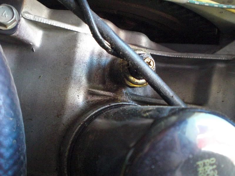

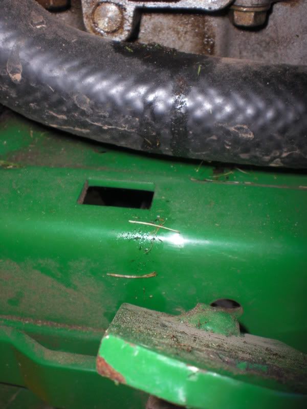

Well after talking up my mower and being in love with it..i was using it for the second time, and not even done with my yard when it started to chug really bad...then smoke rolled out from the deck and it made a hideous sound...the pulley actually broke off the deck..im not to happy at all..when i pulled it into the garage..i found something else that got me smoking even more...there is a sensor/plug? right above the oil filter..well its leaking oil its leaking down the oil filter, onto the radiator hose and, down the frame..i called the dealership..they are gonnna pick it up monday morning...i have no warranty, they tell me they are gonna take care of me and not to worry..but i do worry, i havent even put 3 hours on the stupid thing and all of this happens? whats a guy to do?

Did the idler seize up or did the nut that holds it on just come loose? The seeping oil sending unit is common.
It did not seize up as far as i know because it was mowing great them just like that it died..i did find a washer on the deck but no nut so who knows were it shot off too
