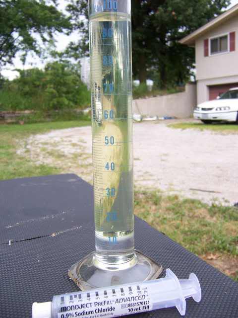

OK, having said all that, let me show you how to test for basic alcohol in gasoline. Remember I have been testing for this stuff for 30 years so I have the high dollar stuff, but you can do it with nothing more than an empty 16 oz. pop bottle and some simple measuring devices.
The basic tools for testing specific gravity and alcohol. Since we a basically concerned with alcohol content the thermometer and float will not be used. The 100 ml graduated made be replaced with a graduated pop bottle or any type of clear container that can hold gasoline and is sufficient size to contain 10 equal measures of known quantity. More on that later.
Since we will be testing for alcohol content in percentage the quickest and easiest way is to measure 90 ml of fuel into the column. Sampling into a clean small container and then filling the column will make getting accurate amounts much easier. DAMHIKT

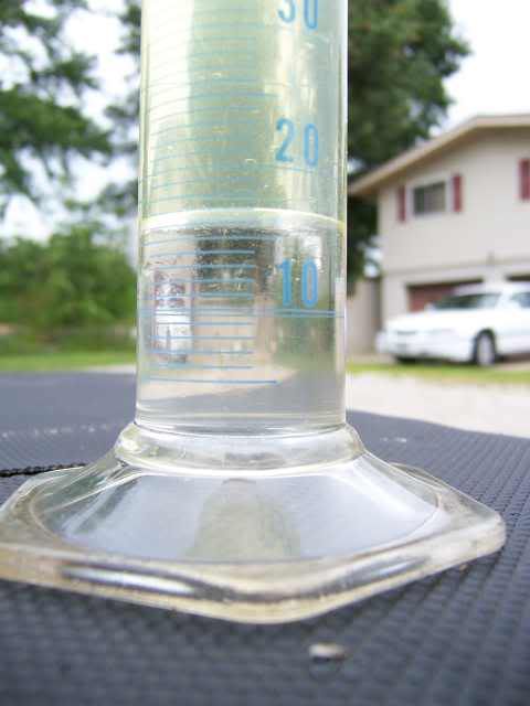

Into the column we add 10 ml of water. The water will go to the bottom of the column latching onto any alcohol it come into contact with, so I use the 10 ml (a cc is equal to a ml in volume). By measuring the water before adding, the error factor of initial alcohol contact is minimized/eliminated in the final results. The addition of 10 ml of water actually measured 11 ml in the column, so there was an immediate net gain of 1% just as the water fell to the bottom.
Once the water is added, the column is agitated ( I just cap the top of the column with my hand and shake it up and down with my left hand) so the water and fuel try to emulsify, then set aside to separate for a few minutes. After 10 minutes of settling, the separation line measured 18 ml. This fuel sample is regular 87 octane so it contained the legal amounts of alcohol as expected.

Besides alcohol the current fuel contains many "emission modifiers" which may be a contributing factor to the milky fluid in the sediment bowls.
If you look closely at the 4th. pic you will see the water at the base of the column has a milky appearance as well.
