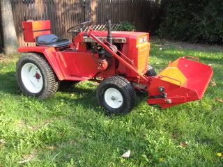

I made a front bucket for my gt wheel horse ( a real garden tractor ) and reinforced the front spindles to handle the weight. Remember whatever you put in a bucket is cantlevered over the front axle, multiplying the wt. the axle sees. Steering get hard with stuff in the bucket.
I guess you could go thru the effort to do one on the machine you have and when you fold the frame or front axle in half you could get a stronger machine and fit the works to it. Good learning experience though. Not trying to be a smart guy, just trying to catch your attention.
Here is a pic of the one I did:
