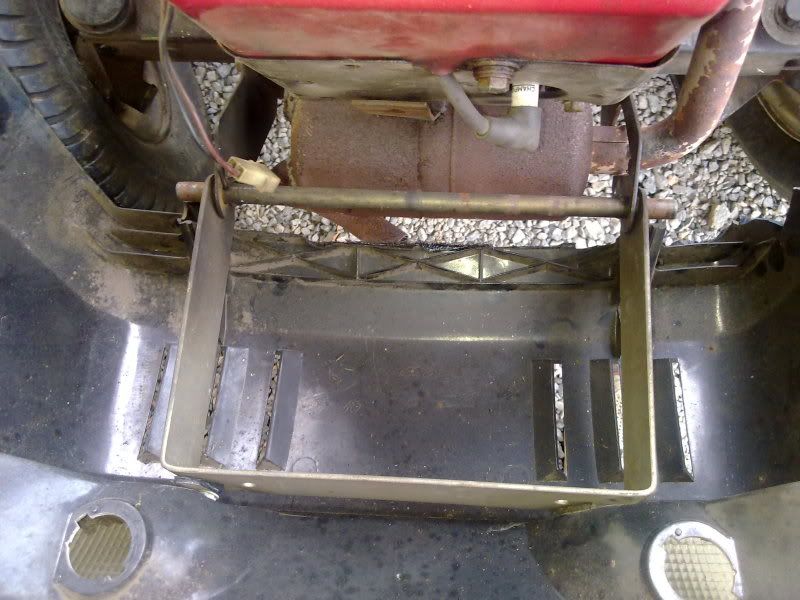

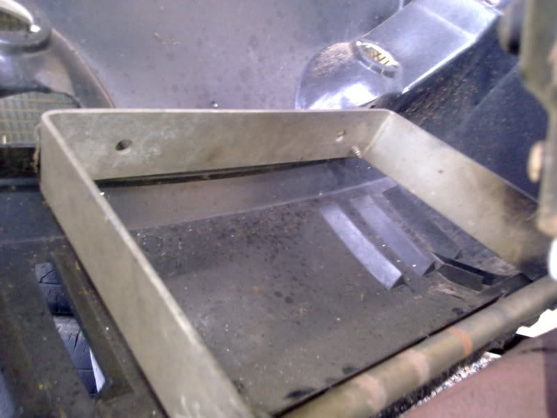

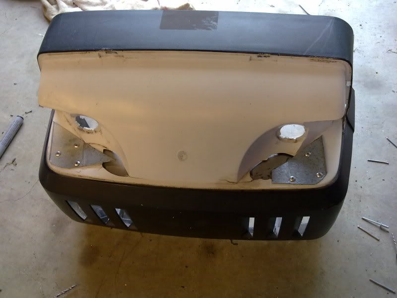

Yesterday I opened the hood a little too enthusiastically and the attachment screws ripped out two chunks of plastic and it all fell off. Sleeping on it overnight and thinking about in Church this morning :praying: I came up with a repair solution. This it it.
Where it is supposed to attach
Two Tech scres with no washer behind the head was all that held it in place

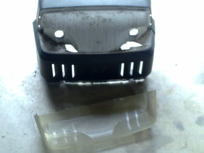

Bit grubby with the lens off
But after a clean up you can see the damage

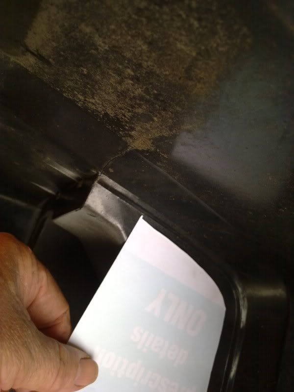

First I made a paper pattern of the corner
Then transferred it to a piece of aluminium

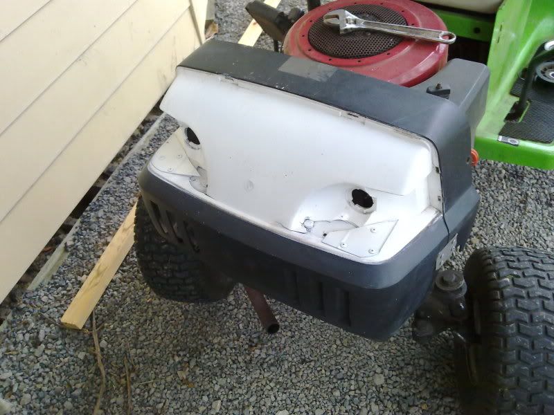

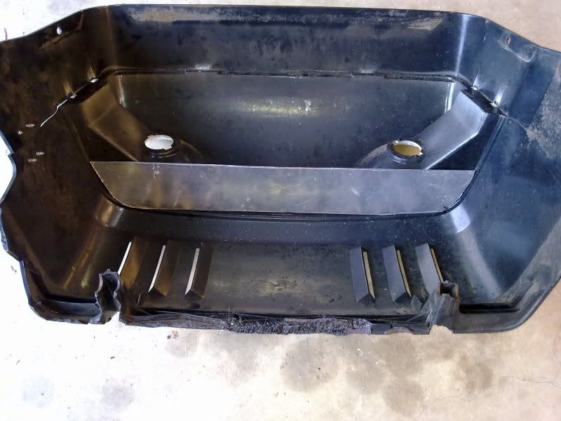

Popped riveted it in place
With some scrape sheet to distribute the load at the back
Bit of spray paint to blend it in a bit
Drilled some bigger holes and used bolts to hold it back together

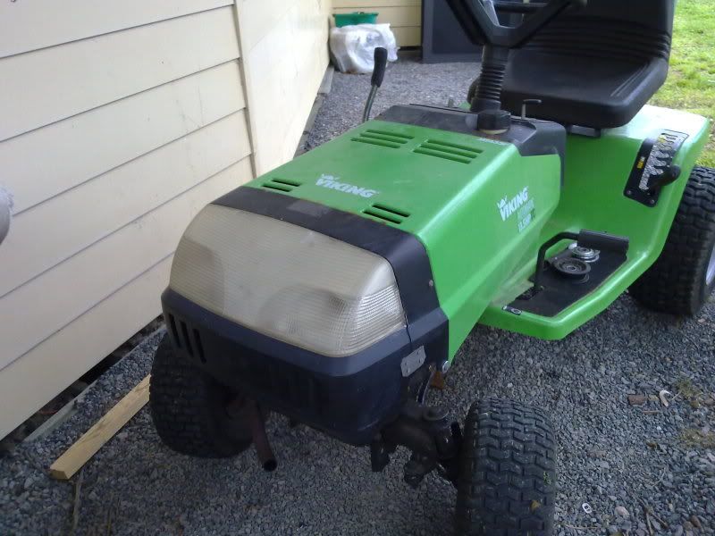

And it fits
Better than before it broke

Very good repair job! I do that, too, using the aluminum sheet. In my case it has always been the lower skirt part of the grille that is broken, where the area around the hinge is attached to the pivot attachment rod, is located. In particular, the hinge point is usually broken out, so I add a piece of aluminum wrapped around the pivot rod and bolted through the plastic with a bolt and nut which is behind the pivot rod.

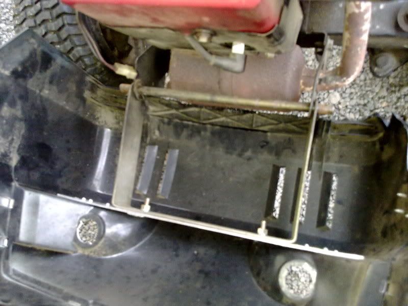

I just noticed that your muffler is directly in contact with the plastic grille, Is there a way for you to create a muffler shield from some of the aluminum you have?
Nice repair. Those hoods are famous for breaking there.

Great looking job. Just a suggestion, if it were me I would go back in and drill some small holes at the end of each crack line to keep it from runing anny further in your hood. Hard plastic is like glass and the cracks will get bigger with time and vibration unless you drill a hole to releave the stress at the end of it. You did A great looking job and I would hate to see you have more problems down the road.
Really good repair. Looks to be what the factory should have done. I agree on stopping the cracks now, that would suck to ruin a great repair job.
