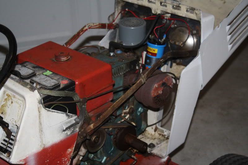

Well I've made some progress on the Custom 6 w/ Tecumseh HH120.
It was a little bit rougher than I thought.
I've haven't seen so much wiring twisted and taped, since my first car with 6X9's sitting in the back window.
Keys were lost and ignition switch was very rough. I added a new 4 post ignition switch.
Toggle switch for headlights was broke and everything was done in black wire, with one headlight still working.

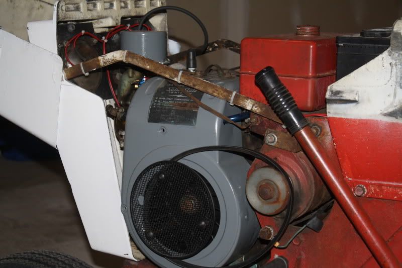

wrong color on engine cover, but Ford Gray is all I had, I could't bring myself to put dirty old cover back on.
Tecumseh SS Ignition was removed and mis-placed. I installed the overnight solutions conversion.
Starter/generator pulley was lost. Hope to have new pulley in the mail tomorrow.

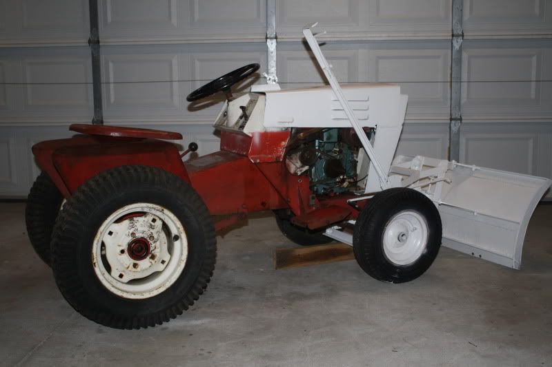

Biggest find was while picking up plow and mowing deck, a ST12 looking to be more complete than this one, sitting wrapped in a tarp under a pine tree. As soon as I can get my trailer out of storage, I'm picking it up.
Plow had sat uncovered under a tree for many years. I power washed it and sanded, wire wheeled it, then two sons helped me paint it. This was their Grandfathers Tractor, that he had bought in 1972. It's got sentimental value to my wife.

Just keep at it and it will take shape :) the plow turned out great.

I bought the ignition with the upgraded Bosch coil. It was $135 to the door.
It might be the most simple thing I've done on the tractor. It took longer to find a spot to mount the coil, then everything else.
I also switched to a 4 post ignition switch, so I don't need a separate 12volt switch.
