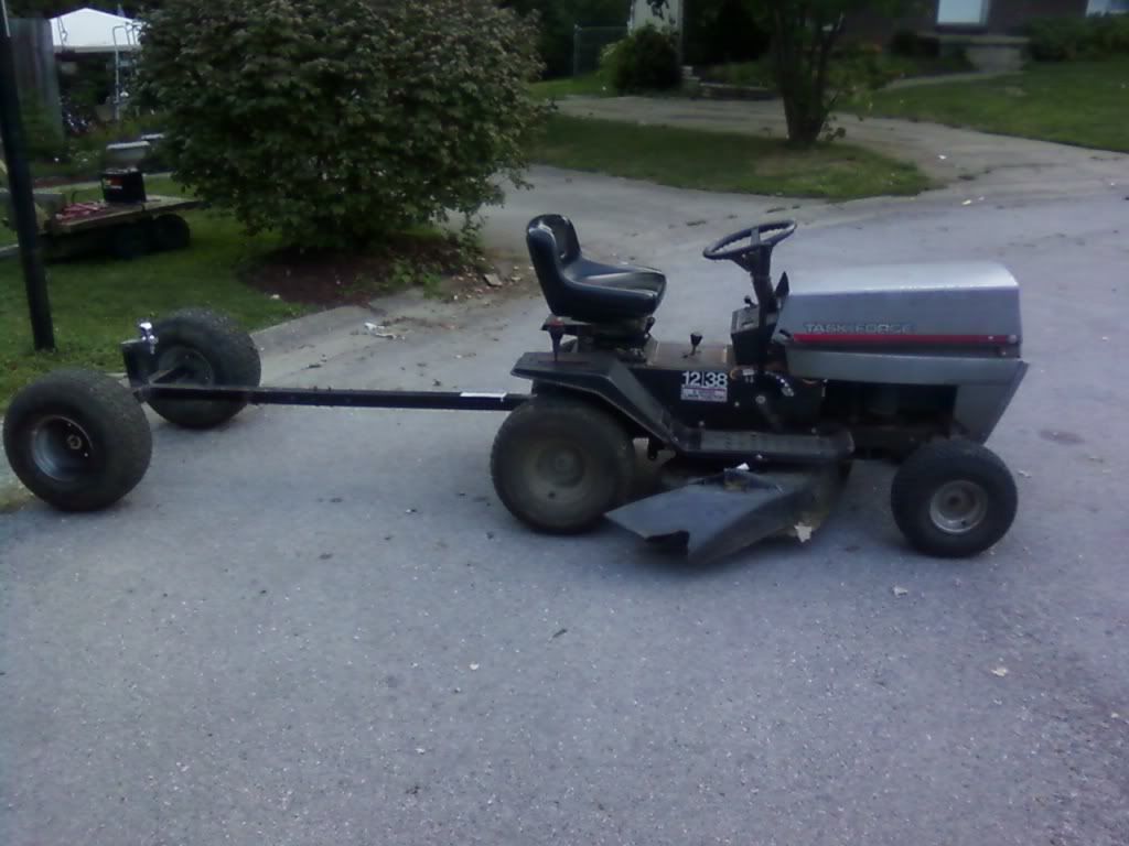

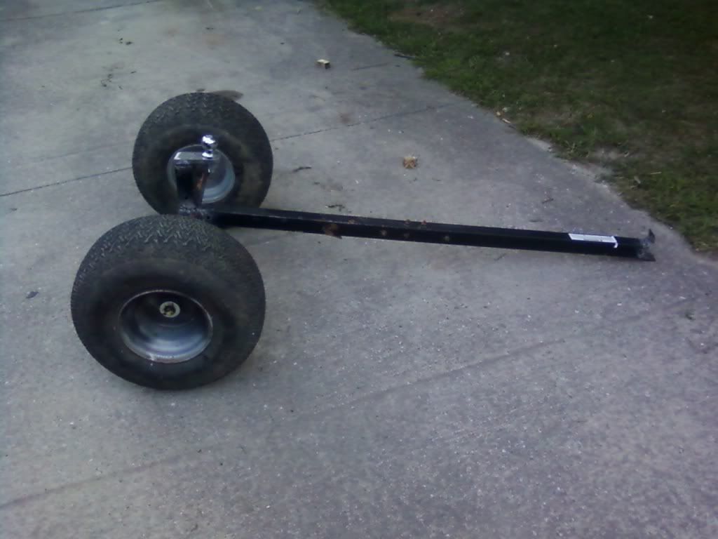

I recently was tasked with needing to move my boat with my lawn tractor and after thinking for a while this is what i came up with. i would like to get some opinions on my work. I'm just learning to weld with a small arc welder so the welds are not pretty but they work.:thanku:
http://i254.photobucket.com/albums/hh115/bran95/Photo049.jpg[/IMG
[IMG]http://i254.photobucket.com/albums/hh115/bran95/Photo048.jpg

The construction of the dolly looks good but I don't understand why you would need one ?
Wouldn't it be easier to just mount a hitch ball on the tractor and hook the boat trailer directly to the back of the GT ?
I know it would sure make it easier to back the trailer up with it hooked right on the tractor.
Wouldn't it be easier just mount a hitch ball on the tractor and hook the boat trailer to the back of the GT ?
if the boat is real heavy it will pick up the front and of a light mower in a second, mine did it to my murry all the time, never to the snapper
it looks good, lets see it in action ...... it will take a bit to get used to 2 piviots, its not to hard:fing32:

yes it probably would have but i didn't want to have to weld or mount anything on the back of my mower nor did i want all the weight tongue weight on the back of the mower plus i can leave it hooked to the boat so so when mowing all i have to do is back up drop the pin and go instead of have to jack the boat down on the ball and everything plus that doesn't limit me to moving it with just one mower. and it is awkward to back up at first until u get use to it.
by the way I'm only 14 years old
That all makes sense. Thanks for explaining it.
I've never found the need for a trailer dolly so it just seamed like a lot more work to me.

yes the coupler does pivot good and the tongue is so long for easier back up.
and thanks for the compliment

I'd hitch the dolly up to the front of the tractor to make it easier to back up.
LOL!:biglaugh:
Yep! I would do the same, but then again I do that everyday or so with the aircraft. Makes parking them a dream.
One of the other nice things about using the dolly is the ability to jack the trailer into a tighter parking space.
Nice job on the dolly!:fing32: A very useful bit of kit and the skills learned while building it will last a lifetime! Kind of a rare thing to find a 14 y/o that thinks about this stuff today!

Looks good. Would take a lot of weight off the rear of the tractor. When I blew the tranny out of my 111, it was because the tractor was popping a wheelie while towing a trailer. Good job.

Old thread I know, but I'd really be interested in something like this to haul my log splitter around. It has a very heavy tongue weight.
441 Posts
If you put a bar that goes up and over the ball like a old style tow truck hook.
you can lift and carry stuff using a chain hoist, rope pulley or boat winch. (see my avatar) This would not interfere with the trailer hook up but give you 2 tools in one. If the trailer is loaded it could be use to lift the trailer on to the ball. I like the long tongue.
