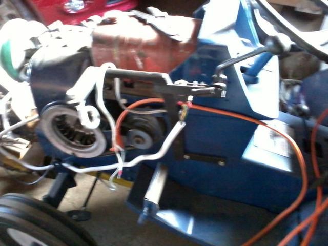

Here is a couple crappy cell pictures of the bracket I made to hold the angle rod and the switch setup for the winch:
The switch is wired to the contactor for the winch, and I made a handle to operate it so I can wear gloves and not worry about fiddling with a tiny switch.
I just have to make a box to cover the switch mechanism, and add in a light that indicates when the plow is raised fully.
