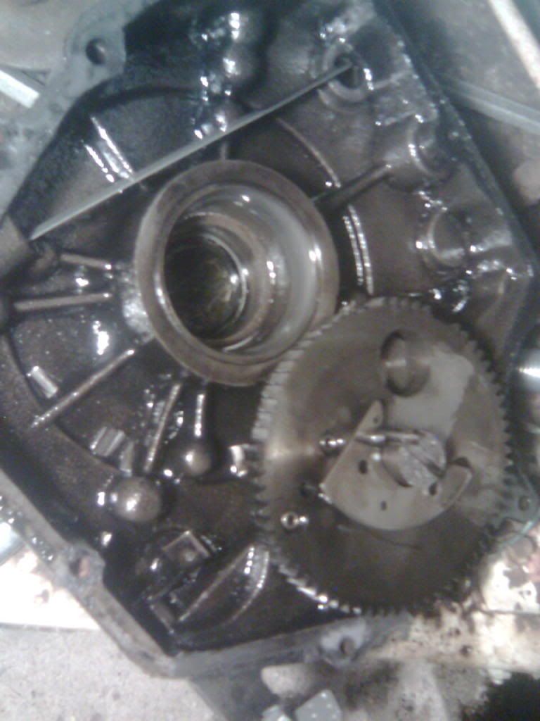

So after spending a few months going over my SS12, I finally got to use it. After about an hour of mowing, I hear a knock from the engine. The knock lasted just long enough for me to think "maybe I should shut that down" and then CRACK! Took the side cover off of the engine, and found this. :banghead3
engine side:
cover side:
Total damages: Camshaft (obviously) shot, govenor is missing teeth, and the teeth on the crankshaft are spalled up. Dunno if I can clean them up enough to make them useable or not. I still have to figure out if there was an underlying cause for the damage, or if the camshaft was just fatigued from years of use and finaly gave out. Before this happened, I did have the head trued up, so the engine did have more compression, though I doubt that had anything to do with it. Time to hit up CL and Ebay to find either some parts or another HH120 to swap in.

:eek:...never seen a cam break like that before,on any engine...looks like it snapped where the compression release pin passes through the journals!..maybe the compression release pin got caught on the lifter and it tore it out ,snapping the cam in the process..
I always dread my HH120's having a catastrophic failure like this,after all,they are 40+ years old and have undoubtedly had a rough life before I got hold of them!..seeing these engines aren't exactly plentiful or cheap for parts,I would probably be forced to do an engine swap if one of mine should grenade..
I guess having a hevy duty forged connecting rod,timken bearings and a sodium stellite exhaust valve dont help your engine last if the cam snaps in half,huh??..:(

Nope not so much. I was kinda shocked that it grenaded like that too, of all the things that could snap, that was low on my list. I'm kinda wondering if there were fatigue cracks in the crank right at that pin already. I thought that bringing in parts for a 12 horse enging to be magnafluxed seemed a bit exessive, so I guess I'll never know. My other suspect is a seized valve, though it seems unlikely. The valves guides and shafts looked good when I pulled the engine apart the first time, and I just topped off the engine with oil before I ran it. And before someone asks, yes the valve timing was correct.
