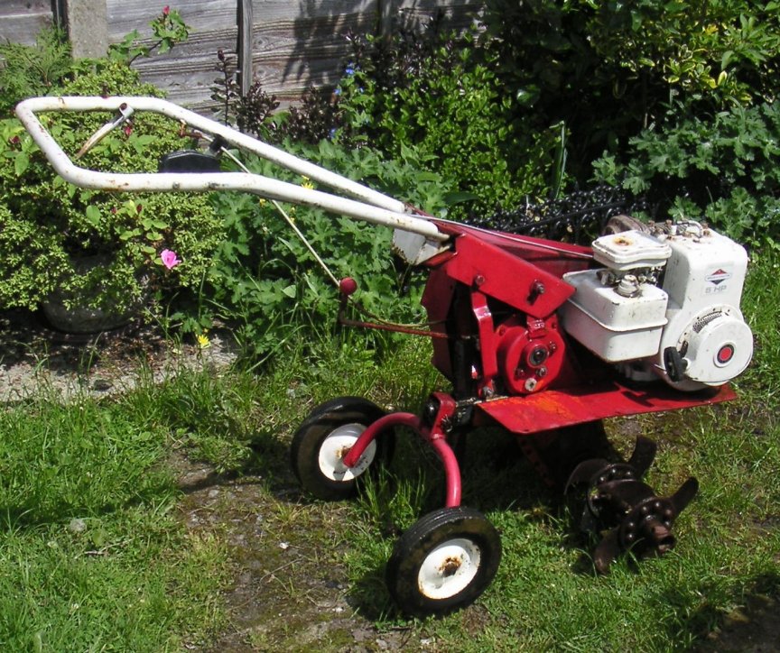

No spark, check the obvious like the killl switch, then if not there, dig in. Look for a sheared flywheel key. Also check to see if the coil is in good shape and wired. I'm sure someone else will drop in and add.

My money's riding on the points being corroded..I just had to yank the flywheel off a 5 HP Briggs on a rototiller identical to yours I sold yesterday--had it all tuned up and ready to go back in December,but my frien just picked it up (or wanted too!) yesterday,and it refused to fire...
The points had a thin milky white layer of oxidation on them already!..its been a very wet year here,and I've seen Briggs points "mold up" in as little as a few weeks and have no spark...I took the points and condensor out and used the wire wheel on my bench grinder to clean them,and it fired up on the first pull..Some 5 HP Briggs use a coil that only fits the 5HP ,it's a "loner",if its bad you'll have to get the right coil and stick with points----others use the same one as many newer Briggs 3.5 - 5 HP engines that have electronic ignition and can be swapped on ,to eliminate the points,and this pain in the crotch chore every few months, cleaning them!..
I'm willing to bet after you get spark ,the carb will need cleaning too,and maybe a new diaphram in it as well...

I have a motor like that one except it is black paint. The points are not fun to mess with. Make sure you have a good plug first.
If you find an electronic coil on 3.5 - 5 HP engines that fits, let me know. I have not looked really, but that would be an ideal solution. i think most of those mower flywheels are too small, but I cant say for sure

If you dont want to pull the flywheel just remove the sparkplug and hook an electric motor up to turn the engine and let it run for an hour or two... It will clean it's own points... Works for me...
5,728 Posts
Check the code # on the engine. If it starts with "85" or higher, it already has electronic ignition. Magnetron ignition will not show a fat blue spark that you are accustomed to seeing with breaker point ignition systems. If it shows any spark at all, it's probably OK. Another thing to keep in mind is that leaf blower operation is not too kind to a standard B&S engine. Exhaust valve life is typically very short, sometimes only one season of use. If you see spark, add some oil to the cylinder to raise compression and see what you got. If the exhaust valve is bad, you will hear a hissing sound in the exhaust as the engine coasts to a stop after you shut it off.

On you little engine there's a kill-switch down between the tank and the engine block. There is a small black coated wire running to a wedge that grounds that wire when you force the throttle plumb off.
Look at that first before you tear anything apart.
You'll love that little thing when you get the problem solved. One pull and its running!

I agree. My engine, that looks just like that one, runs like a ****.[has run well since I bought it - since when is **** a cuss word?]
I dont like pulling that flywheel to get at the points/condenser, but...
Does anyone know the difference between white and black painted engines like these? Do white ones go on pumps? That's what i have noticed.

I've got the same or very similar series 5hp B&S on my Gilson Bro's Tiller. It''s painted white and is the OEM. It's a strong engine and I'll swag it's art least 20 yrs old... I use it quite regularly duing garden season.
I'll chime in on the points being corroded side.
Besides KBeitz's interesting suggestion, getting to the points isn't hard.
You'll need to purchase one of those cheap wheel pullers. They can be had for around $5 at most small engne supply shops. Course if you already have a steering wheel puller or larger gear/wheel puller you're already ahead of the game.
You'll also want to spend another couple $'s for a pack of flywheel shear keys.....
Theres only 3 bolts that holds the cowling on and you'll need a large pair of channel locks or similar to loosen & unscrew the rope starter clutch. Once off you can pop off the flywheel with the puller. The points and condenser are directly behind the flywheel under a tin protective cover. Clean or replace 'em, I recommend to replace 'em. Put it all back together with a new flywheel key making sure you get the starter clutch snugged up good and tight as this is what holds the flywheel on the crankshaft/output shaft.
Checking the kill switch lead is also a good idea. It operates by shorting the ignition to ground which kills the spark so make sure the lead is not grounding to engine ground.
The more I think about it, KBeitz's idea has more merit :D
Good luck
