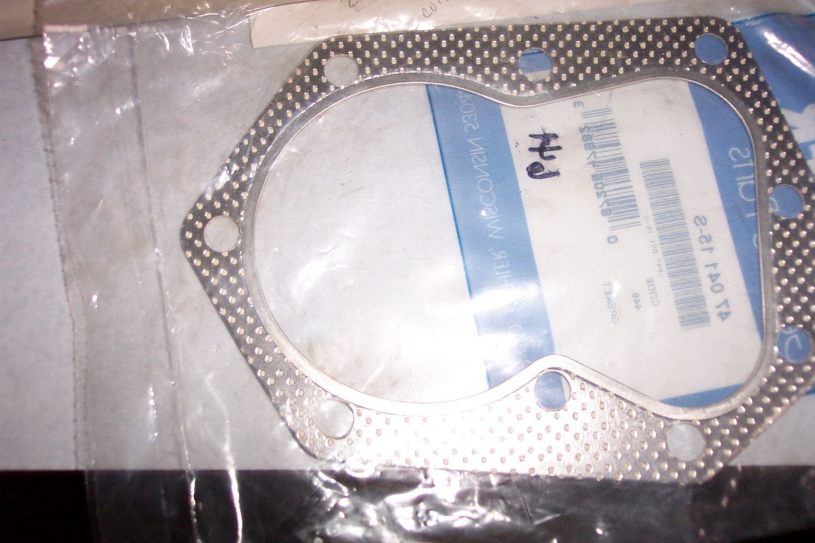

Spend the extra dollar or two to get the real Kohler head gasket. The "cheap" ones do NOT have the sheetmetal at the bore, only the exposed cut gasket material.
The "real" Kohler gaskets have the sheetmetal to help reduce the chance of hot gases blowing out the head gasket.
I can get a picture if you're not sure what I mean :fing32:

click for big pic
This one is for my 12 hp K-301 and cost $6.49 at my local Western Auto / small gas engine repair shop. Part number 47 041 15-S
The sheet metal ring helps keep the hot gases from burning thru the head gasket. Of course proper torque is equally important too.
Torque to spec in the proper sequence, run for one hour and re torque when cool. Re torque again after an additional 5 hours run time.
