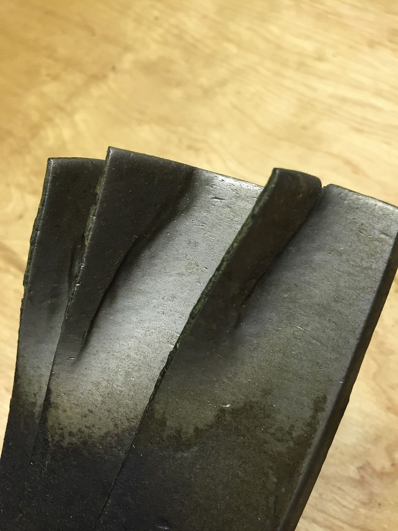

Has anyone ever seen damage like this on 50" MMM blades?
786 Views 9 Replies 8 Participants Last post by  wwxx
This set of blades came off a tractor I just bought. The pictures show both ends of them blades. The deck was in nice enough shape apart from very dull blades. I changed blades and when I spooled up the deck I got sparks and clangs. Instant shut down and noticed a deep dent on the side of deck. The old blades didn't hit it, but the new ones did.
Hmm.
I fixed the dent and then went to look at the old blades. That's when I noticed these wrinkles and cracks. I have maybe eight sets of blades on a shelf and four more sets on decks. None have this damage.
Has anyone ever seen this sort of thing?

Looks to me like normal wear from cutting in dry, sandy soil.
I replace my blades every year - cheap insurance for good performance.
Sheldon
This. I have had blades wear to a point at the end in less than a season because of our sandy soil. It has gotten better over the years as I improve the lawn.
