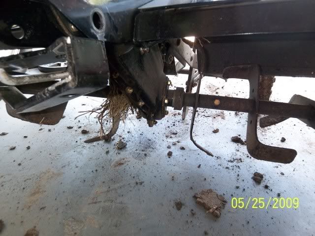

After about 11 hours my tow behind tiller exploded the transmission, actually I hit something and rather than the shear pins shearing the transmission bent in half and the chain made a mess of the internals. Luckily I was able to return it for a refund. I took the proceeds and added a winch and built a ripper which incorporates my harrow disc I already had. All inspired by the projects I have enjoyed viewing on this site. So below are some pics. The winch still needs to be mounted properly, but hopefully Ill be tearing the soil up this weekend.

Yea I built it, used 2x2 tube and angle. My original plans where to incorporate shear pins to break in case tines got stuck which accounts for its overly built size but my initial testing showed shear pins werent necessary as I could not go fast enough to really break anything.
I forgot to add my lessons learned section.
1. I used a remote control winch from HF, unfortunately the remote has an inherrent relay latching time which does not allow for infinite adjustment, ie the sleeve hitch rotates in ~10 deg increments. I attentuated this somewhat by adding a pulley but Im wiring in a regular toggle switch to activate the relays for infinite adjustability.
2. At Tractor Supply I noticed they had a "Quadivator" which had the "S" shaped sring loaded tines, these tines are also available from King Kutter thru Northern Tool. There a bit pricey would make for an easy fabrication job since they bolt right ont 2x2 sqr tubing, and of course they inlcude the spring capablility.
