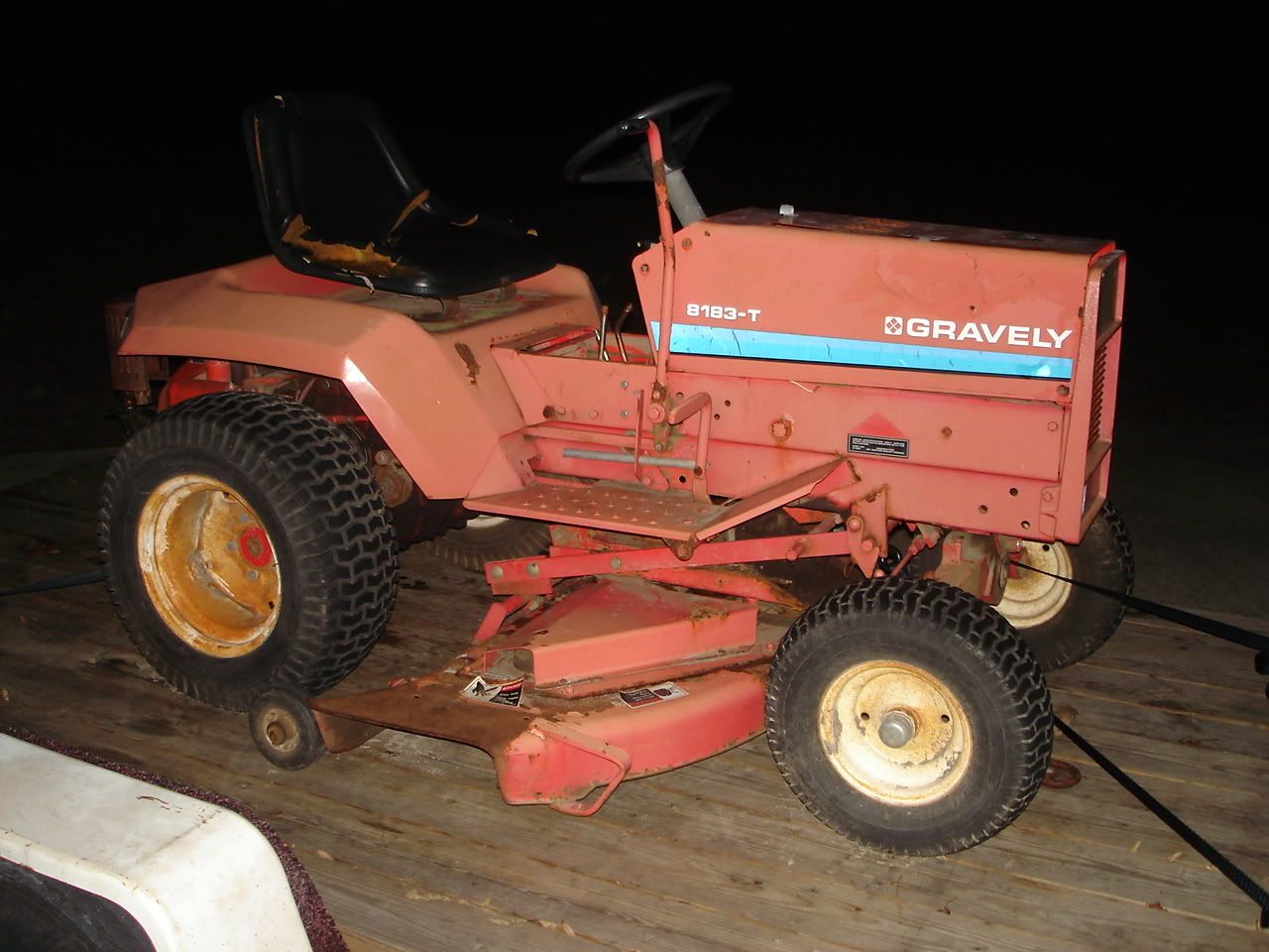

Well.. I'm into Onan's now. Came home with an 8183-T today. Best I can figure, 1980 model. Shows ~ 400 hrs and the tractor looks it. Hour meter still works. Cranks good, runs fairly well... think the carb needs going through. The previous owner was using it as a bush hog that his son could drive "mowing waist high grass in high gear." Needless to say it needs a PTO clutch. It runs if you bear down on the PTO lever... HARD.
Will post pics tomorrow but the camera batteries died tonight taking pic #3.

Pics from last night:
More to come later today.
Well I got some more pictures this AM and finally got 5 minutes to look it over in sunlight with out rain drops. Overall it's very solid and had lots of potential. 95% of the damage on it has occurred from sitting out side. Clutches are in good shape, deck is real straight and will only require minor rework of the front edge, rear fender is straight. Will need the PTO clutch replaced and probably a carb rebuild for good measure. Be a fun project and I look forward to more power than the worn out single I've been running.
