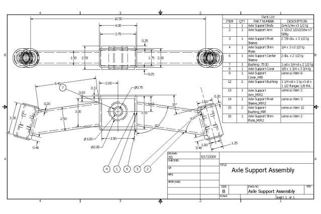

I rebuilt my axle support assembly for my 1976 Dayton (MTD 990) I wanted to replace the cast iron one and increase the spindle bracket to 1". I bored out the cast iron one but I thought it might be two weak so I designed a new one.
Here is a picture of the cast iron support being machined for a 1" diameter.
I have replaced my tie rod assembly from a 3/8 to a 1/2 because I made a front end loader and wanted more strength in the tie rods.
I also made a new spindle housing so I could increase the bearing size. Sorry no pictures.

Beautiful workmanship – you must be a professional machinist (of course the professional blueprint & milling machine is pretty good tip off). I also like the upgraded steering linkage, as it appears that these are marginal on some tractors, especially those that get hard usage. Please post pictures of the finished project.

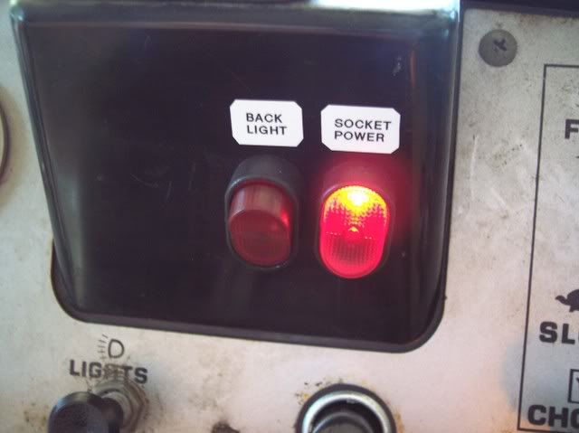

I'm a retired machinist and mechanical designer. I have been making improvements for my tractor for a long time. I also aded a 12v socket for my flashing yellow light which is needed when I drive on the road at night mostly when I use my homemade loader in the winter. I added two switches one for my backup light and the other for the 12v socket. The switch lights up when in use. I also changed my old seat for a boat seat with a high back support. Here is a picture of my homemade loader. I designed it so I could still use the mower since it is shaft driven from the center PTO. I bought this tractor new in 1976.
