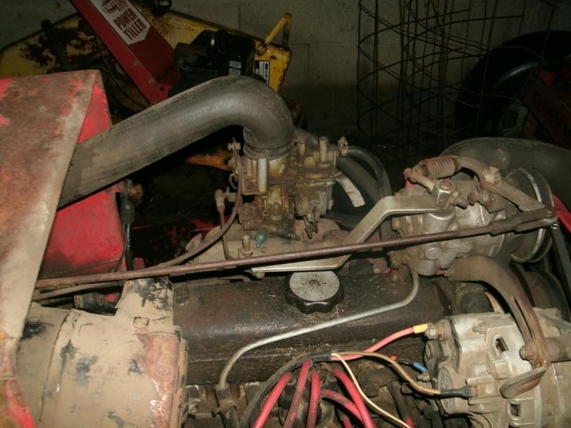

Okey dokey, here is a pic of the governor linkage.

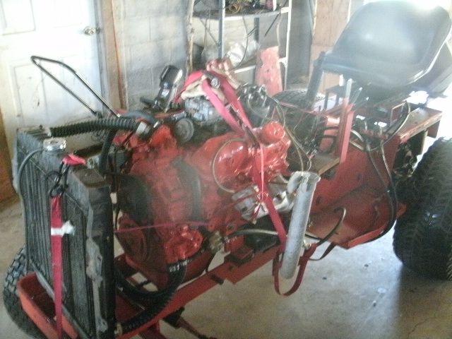

And as for the tractor with the ford V-6...... Here is what's left of it.
Pretty sure that's the same tractor..... No idea why it got disassembled from a functioning tractor.... (with no governor......)
One thing I have found on the 9000 series tractor that REQUIRES them to have the governor, is the driveshaft, and transmission input design. Allow the engine to rev much past it's 3250 governed RPM, and the side loading at the driveshaft/trans input shaft becomes more than the shaft can tolerate, and it bends, or breaks. All it takes is ONCE, and the shaft is done. Make REAL sure your governor is functioning properly, has correct oil level, and belts are properly tensioned is CRITICAL on these tractors. Yes, this IS the voice of experience.
