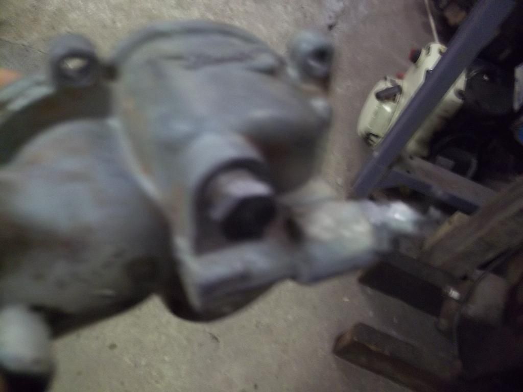

I guess I'm starting this thread to get some help here and there for my 1254. I bought a carb kit from tubeframes and soaked my carb on some berryman chem-dip. Just finished soaking yesterday. Sprayed everything out extensively with brake cleaner and carb cleaner. My problem is that I took the carb apart in like September, hoping that I could till the garden before snow. well, that never happened. So, being as I took the darn thing apart so long ago I can't remember where a couple of things went.
First of all, did I get this right? Are the plug and inlet in the right holes?

Is this plug in the right spot?

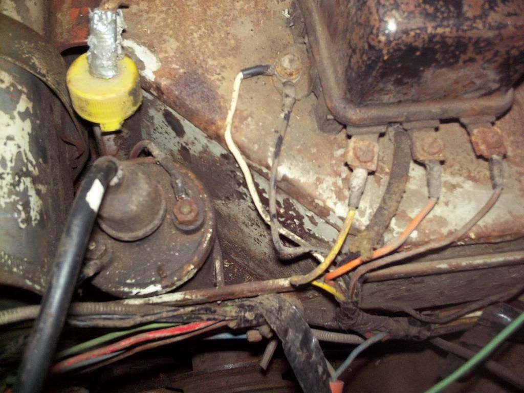

Also, if my regulator has rusted connections, will it work right? Or should I just buy a new one right away? What is the round thing with the plug wire coming out the top? Condenser? Coil? Should that be replaced also? I'm new to these older tractors as this is my first GT.

Looks like the fuel inlet is in the wrong spot, supposed to go on the side not the end.

Do the coil and regulator look like they are in working order? Will they get a connection with all that rust? Or will there still be some good under the rust? I should have taken a wire brush to them.
if not, would this coil work?

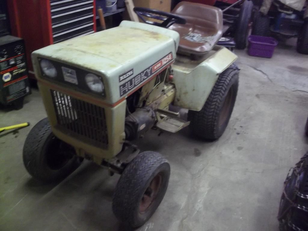

I got a Bolens 1254 myself. Would love to see some photos of your 1254. Thanks
I don't have many pictures of it, but here are a couple from yesterday:
Now, let's see some of yours!
Great looking tractor the 1254. Yes I will post some photos of mine shortly. Cheers
Thanks! It'll look a lot better when I get it running and working...

I would sand the regulator terminals. For the coil, I would just go on EBay and buy a Beru coil, just search for "Volkswagen Type1 bus coil" and you will see a blue coil for around 30 dollars. Should be a direct replacement for yours, as I have one on my 1000.
Do you think my current coil will work? If not I'll just order that one.
No way to tell, I had good looking coils that was junk, and I had some that looked like junk work great. Test it and find out
There's no way you can tell a coils bad by looking at it.... unless its fried to the point where the plastic top cracked.

Yeah, but the kit is more expensive than just a coil. He already has a bracket and wire, and can buy a spark plug for less than $3 at an auto parts store. Also the Beru is a German made coil that is probably higher quality than the one in the kit.
