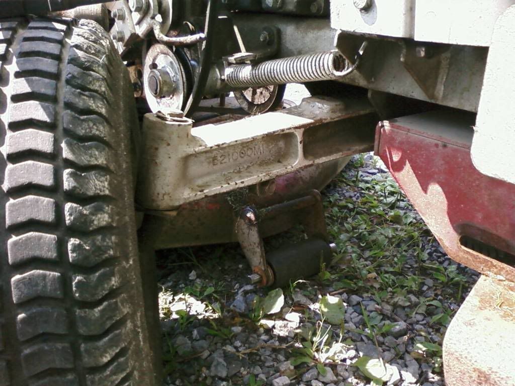

My deck don't have tabs like that on it. Never did from what I can tell. But I did find out there were 2 ways that they mounted. One way like your's and then there's the one like mine. It still goes to the front like your's does but on the deck rather then tabs it came off the top of the roller. look at this pic and notice a bar above my roller. A bracket hooks on that and then goes to the front like your's but a tad diffrently.
Oh yeah I remember that now.:duh: It showed that in the parts book I have for the deck.
