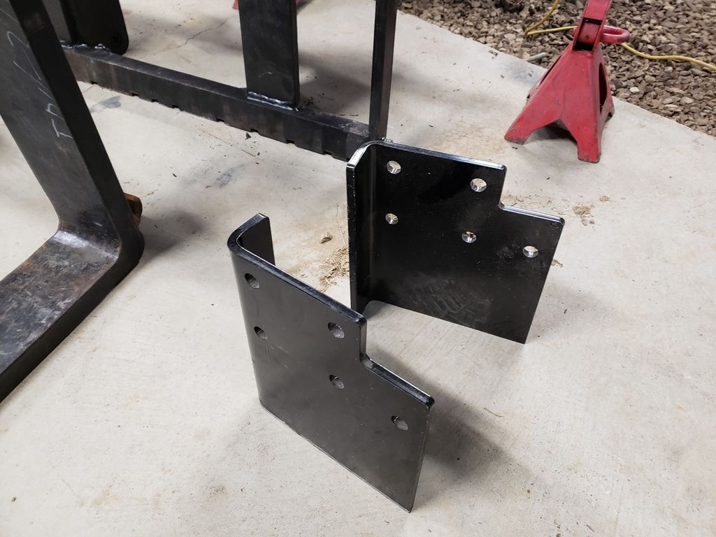

Some leftover pieces of a customizable class V hitch's brackets:
Easy fab job, right?

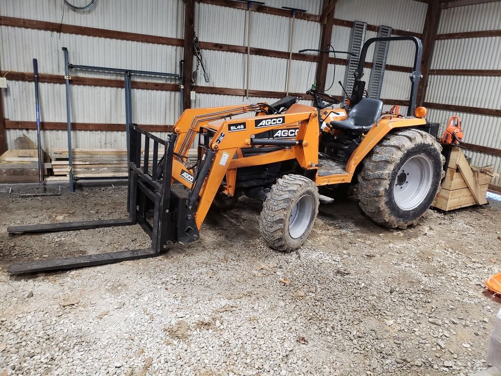

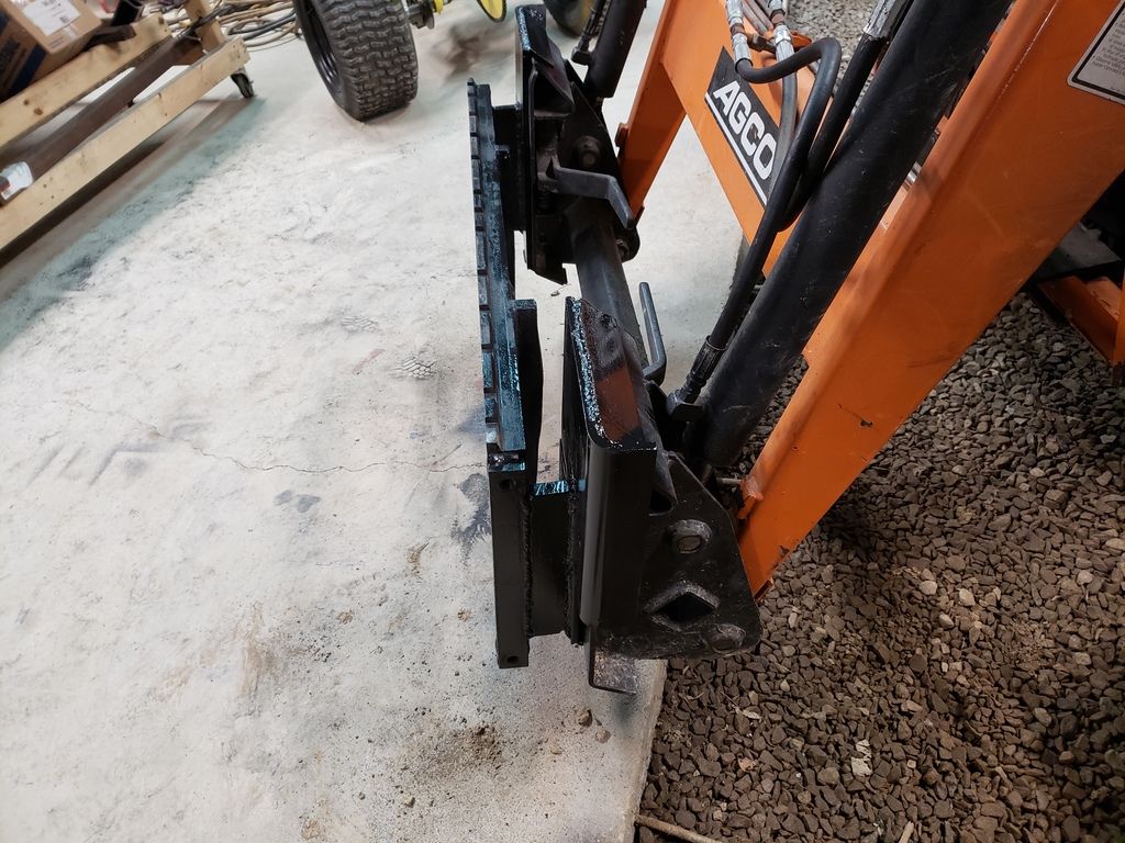

Agco ST35 with SL46 loader will be receiving the carriage and forks.

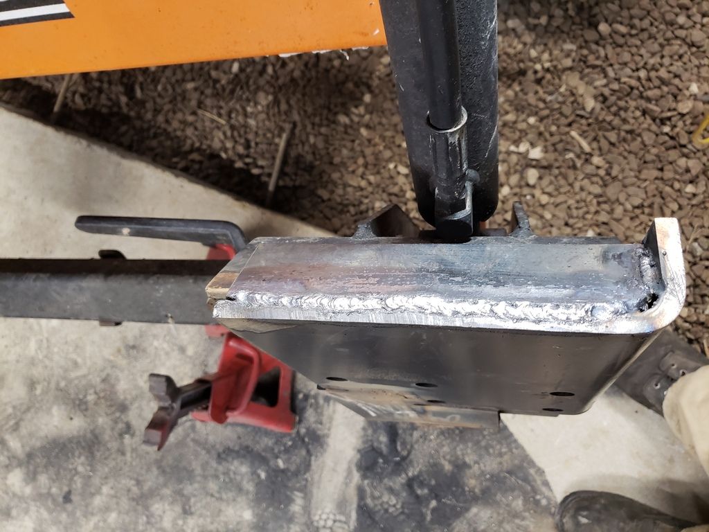

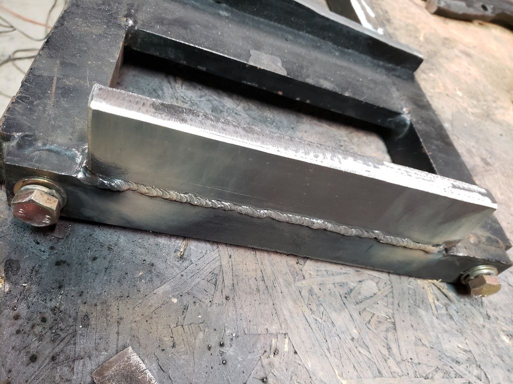

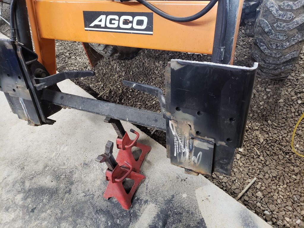

My welds aren't the prettiest, but they hold. Wars aren't won by supermodels...
I did make an angle on the edge of the steel with my grinder, allowing the weld to penetrate deeper and fill the groove. Still not pretty.

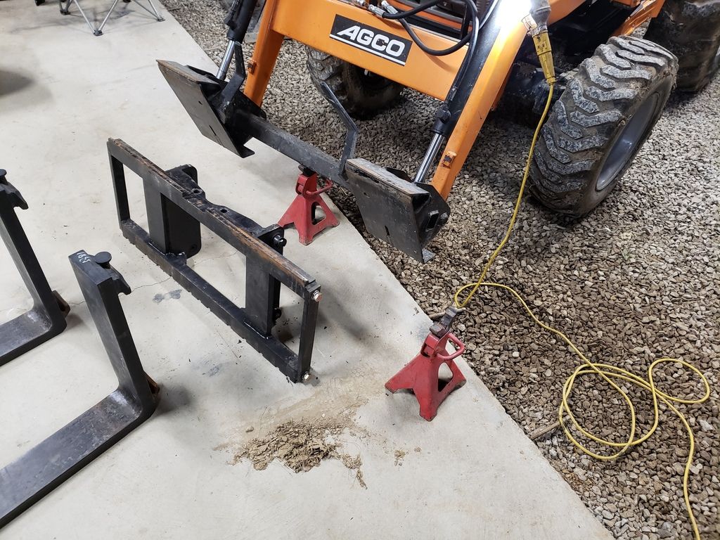

Mounting the carriage

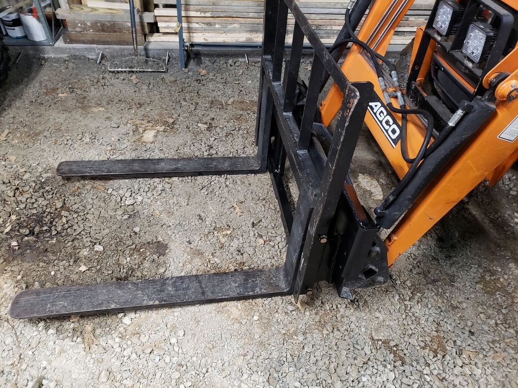

Add the forks and guard... PRESTO!
