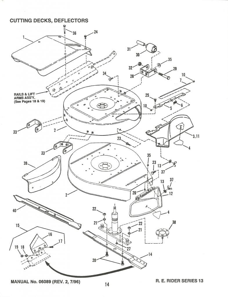

Here's an illustration,from series 13(late 70's early 80's).The blade situation can be very confusing,with production changes between series,new products,(Ninja),aftermarket blades(Gator),and different names,such as "mulcher" blade".#40,is called the recycler blade P/N 7016980(7026453 "ninja" also mentioned(28"). #14 is the standard blade,with the 3 holes in each end for the air-lift kit(#15). I agree with the other members,that the "air-lifts" are mainly used to increase the airflow,for bagging,and to also increase vacuum,for the "hi-vac' deck to straighten up the grass,and also blow the cuttings out better.
My late father had Snapper RER's since the late 60's. I still have his original 30" Standard deck, 28" Hy Vac & SR150. I remember conversations that we had where he mentioned that the add on wing tips were designed for high/thick grass & light brush as well as the lifting effect for a bagger. Adding the weight of the wing tip onto the end of the blade helped the flywheel effect of the blade. One had to keep the blade speed up, engine revs at max rpm. for maximum effect. He never had a bagger since he cut 2.5 to 3 acres at a time. He always learned about a piece of equipment before he bought it. I have him to thank for my Snapper addiction.

p.s. The blade I have was sold as a kit, from Snapper dealer, with mulching plate that fitted under the deflector in the original position. It looks similar to the illustration, but may have higher 'wings' .. or not.
