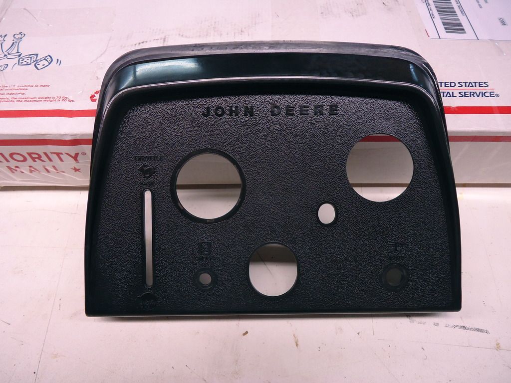

Sorry for the bad pic I was shooting into the light, but mine were all black and worn off.
I used an automotive touch-up pen ( like a marker not a brush).
The 175 was silver. It is very firm so you can use a very light touch.

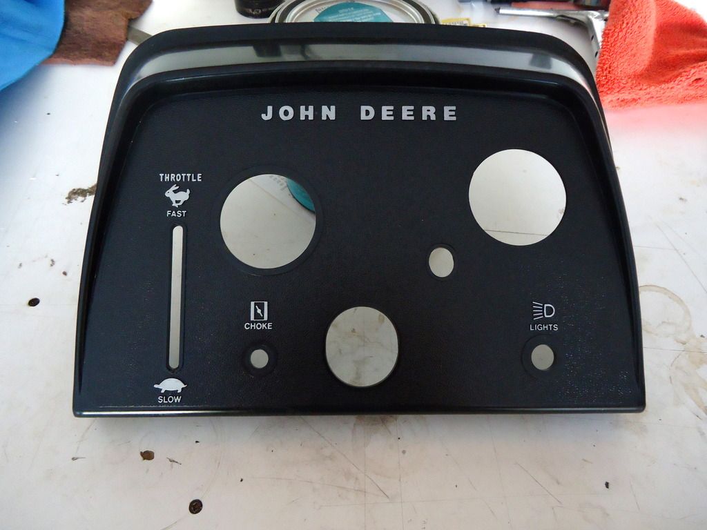

I don't have a before picture, but this is kind of what it looked like (discolored, faded, greyish):
This is after:
It's hard to capture due to the "shine" and reflections from light source. I'll get another picture after I paint the raised portions.

Highlighted symbols with a silver paint pen (couple of coats):
That looks better than new.
