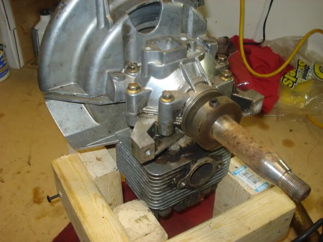

Here are some pics.
Nasty crank...polished that up.
Here's what I found when I opened it up. Lots of moisture there at one time.
See the rusty crud at the bottom of the crank.

LIke my little engine stand..!!

Nice pics, I don't see any deal breakers there, steel wool with do a good job of removing surface rust. The piston is not that bad either, but I like fresh ones with new rings and seals. You should have a runner there soon. Keep us informed.
