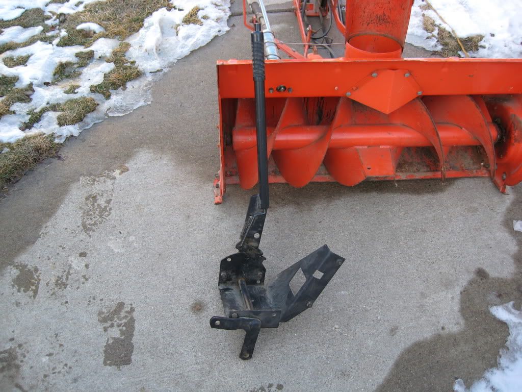

im not sure of model numbers but this is what the hitch should look like.
it will fit your machine but you will also need a longer lift rod and the lift lever.

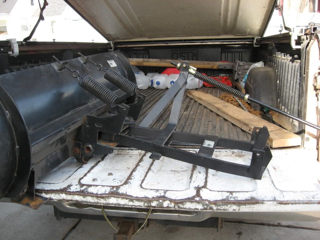

hitch & blade

no, the second picture is of the lift lever you will need.
the link at the bottom of my post is a picture of the lift rod that another member posted.
