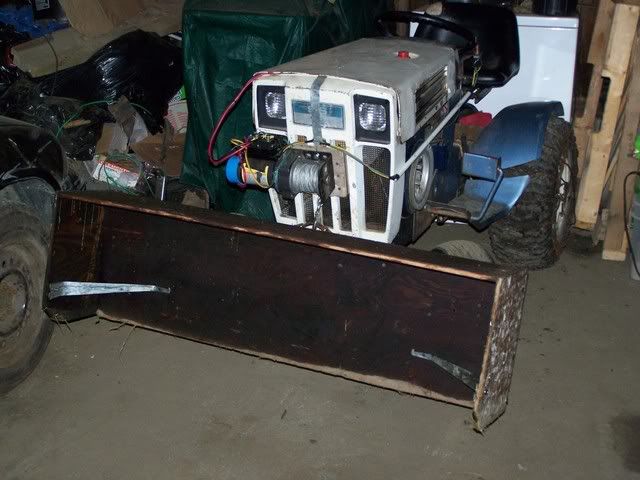

Had to make something to deal with any snowfall until I get to working on my metal blade. All the pieces are at the school shop right now, and I haven't had much time lately to work on it. Now that I have made this wooden scoop, I can take my time and hopefully churn out a quality homemade blade.
Made the "scoop" for free - it uses a piece of shelving as the main frame, with plywood screwed into it. I took the push frame that I made out of wood for my metal plow (I used it to mock up things to my tractor). It is actually plenty strong for snow. I tested it out pushing wood, and it didn't break, so it should hold up fine for now.

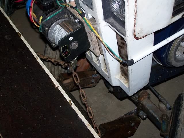

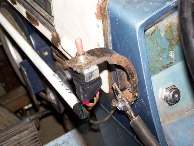

Thanks Keith! As far as the key switch, I can help you with the wiring since this one was not designed for engines that ground out the SSI to shut off. I added in a relay to fix this. I'll pm you tonight with the details. I used a ski pole as a sort of protective conduit for the plow wiring, because I don't have the S/G pulley cover on (It interferes with it somehow, I'll figure that out later). I had to make a wooden winch mount for the grill - there are two would blocks that keep the winch base from rotating, and the metal strap takes most of the weight.

Ok. I got real desperate when we got our two inches of snow, as we haven't had snow since october. This thing actually worked great, with no problems, other than steering. First time "plowing", but I'll save my excitement for the real snow, which will hopefully be on its way this week. Just got tri ribs, so that should help with steering.

Whats wrong with the nose cone? I can understand any concern you might have, but the plow itself connects to the axle, and 99% of the weight of the winch is supported by the metal strap. The nose cone simply keeps the winch from twisting.
