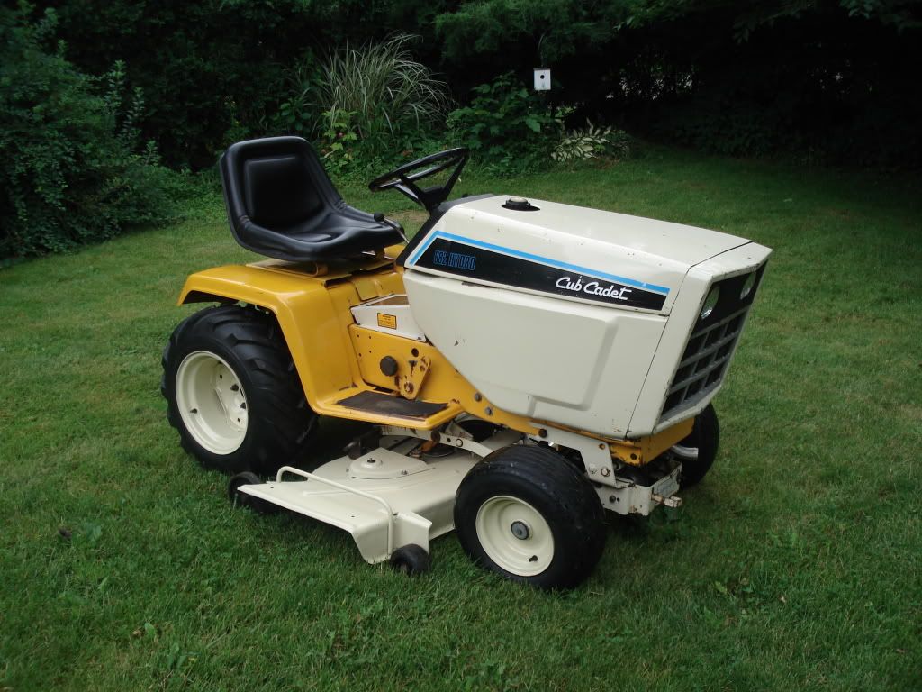

I have the Deestones up front:
It's all in what you want, they are much less aggressive than the Vredesteins. I do like the looks of the V61s, but I doubt they really make any actual difference. Front-mounted weights is the key for more steering traction.

Thanks Bob for your comments and pictures. Your point above is exactly what I am debating. I agree the V61's look better, but is their actually any performance difference for double the cost. To steal an image from Glockem's thread, here is a pic of the V61's installed;
The ribs are certainly wider, as their are fewer of them, but I don't really think they are substantially deeper.
