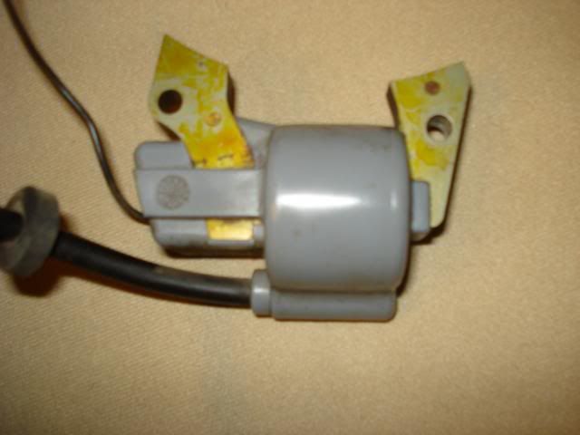

Hey guys...I've been reviewing Viking's post in the stickies about doing the NOVA II to fix the transitors on dead coils. Anyone want to venture a guess as to where I should remove epoxy to find the positive terminal on this post 1983 (2) prong coil?

Follow the small wire, should be under that black epoxy. Dig away at it slowly and carefully.
What should I be digging with ? What is best to use to carve through epoxy-even on the 3 prong ones with the bump?
Thanks Viking !!

anyone have any ideas on what would work best to dig away at the epoxy?
197 Posts
I've never done this before...but have all the parts to fix my extra Suzuki coil and will be...but I planned on trying:
picks, my favorite screwdriver, box cutter...lots of stuff. I got the impression you didn't need to worry about the old transistor much since you'll be replacing it! If you break a wire you care about, you have plenty with the NOVA II.

I am going to try the same thing atomix, i was worried about breaking something off and not having anything to solder the nova II wire to...
197 Posts
Suppose I'd probably put the dremel w/ a grinder to use as well if it was taking a while! May actually be best since you can go slowly.
